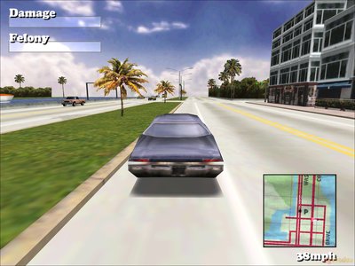

Dege: If you're wondering, the game works fine (the draw distance being terrible isn't dgVoodoo2's fault):
392.28 KiB
1289 views

Yeah, thanks, it works for me too.
That's why I don't understand what the problem could be for Tumek5.
