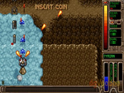

I'm amazed that you managed to figure out how to modify OpenTyrian's source code and build it, but can't figure out how to set environment variables. The simplest way to set a temporary environment variable is just to type it into a command prompt before running the game from the same command prompt:
set SDL_VIDEODRIVER=directx
opentyrian.exe

Also in case you're not aware there's a SDL2 version of OpenTyrian. It has aspect ratio correction implemented, though I suppose dgVoodoo2 can always handle that anyway.
Dege: this brings up an interesting question actually. If I want to run Tyrian integer scaling with no filtering at its proper aspect ratio (4:3) then I would need to have different integer scaling factors for different axis. Is there any chance that's easy to implement? Since I have a 1440p monitor I would need to run Tyrian at 320*5x200*6 (1600x1200) centered if I wanted a pixel perfect picture. Or if I wanted to I could do 320*6x200*7 (1920x1400) which would still be less AR distortion than using equal scaling factors for both axis and fill out more of the screen. This is going to get more important for 320x200 & 640x400 games when we get higher resolution monitors.

Thanks; it was really that easy to set environment variables? I thought you were supposed to download some kind of Linux-command prompt for Windows (or even edit some of the SDL source-files and then recompile SDL.dll), like I had to do to compile opentyrian (that was a nightmare to compile). Now I just made a batch-file named start.bat, and put those two lines you named in that file to quick-launch SDL games with dgVoodoo2. Kind of embarrassing that I didn't figure out that on my own, I know.
I did not know of a SDL2 port of opentyrian; I thought that the development of opentyrian in general halted a long time ago. Might be worth checking out.
Well, since dgVoodoo2 handles both the 3dfx/glide API and earlier versions of ddraw/d3d, SDL 1 support as of now works with the "set SDL_VIDEODRIVER=directx" workaround. Is OpenGl support in dgVoodoo2 a feature that's planned in a future release? I have no idea whatsoever how much work that would be to implement, and one of the few benefits I see with OpenGl support as of now is better native SDL support maybe?
