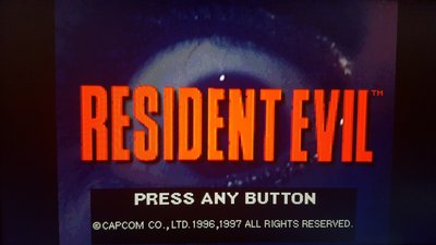

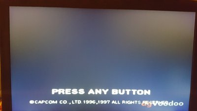

Yeah, I have tried DGVoodoo and I keep getting and blank screen or blank backgrounds
97.97 KiB
2275 views
with Voodoo
and this one is with standard setup with compat win 95.
166.19 KiB
2275 views
I'm tearing my hair out, and I have played the remake but I have mods I want to do, I wanted the PC version as it is open - I have ideas for a Wesker and Ada RE 0.5 storyline.

Reply 4 of 15, by Dege
I've just tried RE1 with dgVoodoo 2.54, and as CoolGamer said, it works for me with video card set to 'ATI Radeon 8500'. Any other videocard type gives black background and other rendering glitches.
Also, cutscene movies unfortunately works only in windowed mode (tiny appearance in the middle of the window though), in fullscreen they results in blank screen (sound only).
So, what I did:
- Run dgVoodooCPL and select/add the folder of RE1 into its list
- On DirectX tab, select 'ATI Radeon 8500' from the videocard dropdown list
- Press 'OK'
Run NEWEUR.EXE in Win95 compatibility mode and aside from the blank screen for cutscenes the game should run properly. Ok, well, aside from some background rendering glitches (horizontal and vertical garbage lines).
You also have additional ways to go:
- Select a higher resolution on DirectX tab, and maybe MSAA to get improved appearance
- Disable 'Application controlled fullscreen/windowed state' and 'Disable Alt-Enter to toggle...' options on DirectX tab, and select 'Windowed' mode on General tab to run the game in windowed mode. In this way you'll see the cutscenes and also be able to switch between fullscreen/windowed mode by Alt-Enter

Reply 8 of 15, by CoolGamer
letmelive wrote:
Unfortunately, I still had the same issues, the backgrounds in the game wouldn't render, the stair case rails did though, and the character was fine.
I found my RE1 CD and replicated the above error and the main menu error that you experienced. These glitches happened either when I did not set the Videocard to "ATI Radeon 8500" or when I forgot to set the config folder to the game folder. Most probably you forgot to set the config folder to the game folder.
Config folder is shown under the dgVoodoo logo of the control panel. You need to press ".\" button to set the config folder to game folder. Do this first and then set your videocard to "ATI Radeon 8500". dgVoodoo.conf file should be created next to the game executable when you save everything.
When I followed Dege's instructions (and correctly set the game folder and ATI Radeon 8500 Videocard per his instructions), the game worked fine. I also want to mention that I ran the game with "NEWEUR.EXE /blaster" or "NEWEUR.EXE /mystique" switches to enable to hardware acceleration. I did not see vertical garbage lines, but I only tested the first room.

Ok, sorry for the delay, just got my laptop back.
the DGVOODOO will not allow me to save the file in the RESIDENT EVIL Folder - the Apply settings don't go grey to confirm the settings have be saved. Any ideas?
Reply 15 of 15, by letmelive
Dege wrote:
Try running the CPL in administrator mode.
If your game folder is somewhere under c:\program files\... then it may not able to write the config file there.
Thank you so much, this resolved my issues 😁 - now I can start modding 😁
