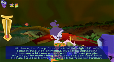

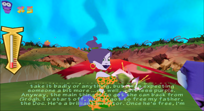

I would like to report an issue relating to the current latest version of dgVoodoo (v2.79). It seems that this version of dgVoodoo causes some graphical issues in Tonic Trouble (Retail) that previous versions didn't have. Let me show you my findings.
Pay attention to the dialogue boxes. It seems that dgVoodoo v2.79 removes the background from the dialogue box completely, while v2.78.2 has the background appearing just fine.

dgVoodoo v2.78.2 (Correctly Displayed)

dgVoodoo v2.79 (Incorrectly Displayed)
I also noticed that Super Ed's model flickers in certain areas of the game. I'm too lazy to post a screenshot about that here 🤣.
There are probably more graphical issues that I just didn't cover here but these were the ones that I noticed while playing the first few levels of the game. I am unsure why these graphical issues occur but in the meantime I'll just stick to dgVoodoo v2.78.2 until this problem is fixed. I just thought I would let you guys know about this.
Reply 13 of 16, by RibShark
Garo wrote on 2022-06-19, 02:03:
The background for the dialogue box actually never appeared on old compatible PCs, nor I believe does it appear when using the reference software d3d6 renderer. So this isn't actually a bug with dgVoodoo, but rather with the game itself, and earlier versions of dgVoodoo were "broken" in such a way that actually fixed the game bug. Not sure what caused this in the first place but it would be nice (if it is an artificial limitation from dgVoodoo to better match d3d6 limitations) if there was an option to disable whatever "fixed" this.
Reply 14 of 16, by Dege
RibShark wrote on 2022-06-19, 05:55:
I think it should work because it must have worked when the game was developed.
According to the internal D3D state the blue background should appear, altough how contemporary vs later hw rasterizers handle out-of-range z-coordinates is another question (it's not defined in the DX specs).
I think I'll reupload 2.79 with a fix.
