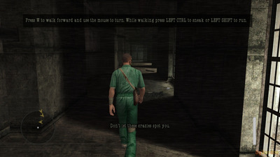

Please add support for Manhunt 2.
Manhunt 2 works fine:
249.49 KiB
2539 views
You need to be specific about what your problem is.
