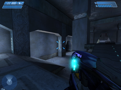

Vaporeon wrote on 2020-05-27, 16:38:Hey, was anything found on the above plasma glow issue?
Was this issue fixed only partially? I thought it's working with the 2.63.1, I mentioned it in the changelog (Fixing a minor D3D DXBC generator bug (Halo CE)).
hmm, it still looks the same in the latest stable and the latest WIP.
Umm, ok, thanks! Then I'll check it out, I may ask for a savegame or sg like that if it requires a special weapon/location to reproduce.
Load the MP map "damnation" and there is a plasma rifle on the ground (weapon in that image) in a room that is directly next to the waterfall.

Vaporeon wrote on 2020-05-30, 19:25:Load the MP map "damnation" and there is a plasma rifle on the ground (weapon in that image) in a room that is directly next to the waterfall.
Thanks! (though I used cheat_all_weapons instead, proved to be more simple)
So, I debugged how the plasma riffle is drawn and turned out that the glowing plasma-power is always rendered but with varying transparency factor.
For example, it's clearly visible when it's lying on the ground. Or, when I hold it in my hands and make a shoot then it fades away gradually.
It's not clear for me exactly how, but the results of some occlusion queries also affects the value of the transparency factor. The more visible pixels the more opacity.
The thing is, when resolution is forced (to be larger) through dgVoodoo then occlusion queries report more visible pixels than expected, that's why the glow isn't (almost) fully transparent.
I tried the game with unforced resolution/MSAA and it worked as expected in that case:
The solution would be scaling the result of occlusion queries according to the resolution. I'll consider it for the 2.7.x series (but not for 2.6.x).
