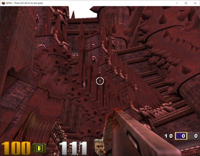

Using the build from WIP66, the Napalm build has rendering issues even when not opting for Napalm extensions by selecting "voodoo_2" in the configuration. I have prints that confirmed only voodoo_2 supported extensions were reported, but the sky rendering in Quake3 was messed up with 3Dfx OpenGL stand-alone ICD 1.0.0.508.
The attachment q3a.jpg is no longer available
3Dfx OpenGL ICD 1.0.0.734 does not want to load with Napalm extensions, probably this is not a stand-alone ICD. MESA FX 6.4.2 detected Napalm extensions, invoked grSstWinOpenExt() but textures were all messed up and seemed to run slower (about half the FPS) of MESA FX 5.0.2 compiled to use Glide2x. Not sure if the textures were due to FXT1/S3TC compression.
It seems that when "voodoo_banshee" was selected in configuration, the NumberOfTMUs was still being honored and resulted in a 2-TMU "Frankenstein" Banshee. 3Dfx OpenGL ICD 1.0.0.508 and MESA FX do not seem to handle such case well. Changing the NumberOfTMUs to 1 in the configuration fixed the issue with both of them. Perhaps, the configuration should take "voodoo_3" instead of "voodoo_banshee", and if NumberOfTMUs is 1, then it becomes Voodoo Banshee. The final 3Dfx reference Win9x drivers for Voodoo2 and Banshee shipped with the same 1.0.0.508 ICD.
