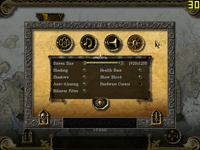

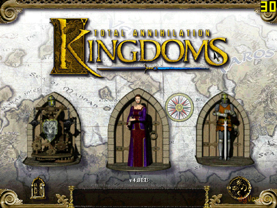

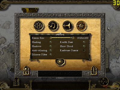

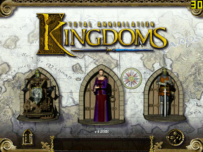

Has anyone ever gotten TA: Kingdoms to work 100% with dgVoodoo? I just recently tried the newest version (2.62) and several issues are still present. It didn't work with 2.53/2.54 either, so I don't think these are regressions.
1) Intro Movies are just a black screen. I know something is playing because there's audio, and the dgVoodoo water mark appears (as does the FRAPs display, when I have it on). But there's no video. This doesn't work in native DirectX either, it only works with the Software Renderer or Glide Renderer.
2) Font Corruption in the menu screens (not during the game). I play at 1920x1200 or 1600x1200 (depending on the renderer, as Glide doesn't support widescreen resolutions). The menu seems to render at 640x480 regardless, so I don't think that's the issue. The font is corrupted when using dgVoodoo compared to native DirectX/Glide/Software Renderer (this problem only occurs with dgVoodoo).
I've uploaded screenshots taken with FRAPs of both dgVoodoo and Native DirectX--and left the dgVoodoo watermark on, so it's easy to see which image is which.
    357.05 KiB
    1269 views
    411.52 KiB
    1269 views
    380.94 KiB
    1269 views
    399.73 KiB
    1269 views
Reply 1 of 6, by willow
Dgvoodoo is only used in software MMX mode and not accelerated mode (direct3d and glide).
With nglide, glide renderer is present. If you copy glide*x.dll in TA kingdoms folder, glide renderer is not present like if dgvoodoo is not initialized.
I you select direct3d mode, black screen and not dgvoodoo watermark
in software mmx mode, dgvoodoo watermark and movie works. No display bug
it's strange.
Reply 2 of 6, by Dege
Thanks. I made some changes in version info of Glide modules, now dgVoodoo is usable too (Glide3x).
D3D hw accelerated seems to get stuck with 3 monitors in the device enumeration. What if you enable only one monitor through the dgVoodoo config?
For D3D accelerated, use the ATI Radeon 8500 virtual card. Or just use the Glide renderer, D3D seems to be the worst in quality.
