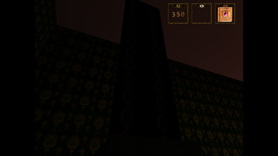

Seems like there is a bug with some alpha textures (not transparent), look at chains in attached screenshot from latest wip

Your screenshot is way too dark to see anything, but loading the save game I see an issue with the transparency on a chain, but the same happens natively and with Glide (nGlide) so I'm guessing it's just a bug in the game itself.
I wonder why this game seems to ship with OpenGL files and seemingly no way to active a OpenGL render.

I had a quick look at it. That texture has no alpha channel so the transparency could only achieved by colorkeying. Colorkeying is hardwiredly disabled, even colorkeys set to some textures are plain zero (black).
If I force-enable it then the chains look as expected but it makes other things to appear bad (tranparent sky instead of black, etc).
I think it's the defect of the D3D renderer, or the game in general if it comes with Ogl too.

Sorry about that, but game brightness settings does not work (maybe you can only control it through dgvoodoo settings?).
Nglide picture on other hand is overly bright..
