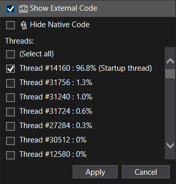

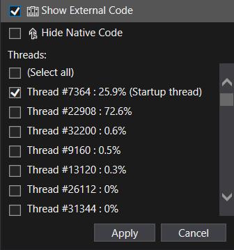

Ok, I tested MM1 myself and now I know why I thought that only the sw renderer worked with dgVoodoo: because DDraw.dll is loaded from the system folder for some reason. So, I hexedited the executable and applied the 'bdraw.dll' trick.
The hw renderer worked with dgVoodoo without any problem, out of the box. However, with D3D11 I experienced very heavy performance stuttering and intermittent freezes, as reported.
With D3D12 on the other hand, it just worked perfectly smooth. I was curious so profiled both D3D11 and 12, see the attached images.
In case of D3D11 a background thread, on which nVidia's driver thread is running, consumes 72%(!) of the total time, leaving only the rest for the game itself. I don't know what it's doing, even the call tree doesn't really reveal it, but my guess is that it's crawling in a monitoring loop (or sg like that) with high priority.
This explains the stuttering because the game runs with single processor affinity. So, the game thread is choking on the background thread.
With D3D12, everything is executed on the main thread. This is because dgVoodoo D3D12 detects the processor affinity and switches to single threaded executing if only one processor is enabled (it works even dynamically).
Doing background threading on one processor just causes unnecessary overhead, I remember experiencing this same bad stuttering with Baldur's Gate, that's why I implemented it all that way.
    11.19 KiB
    2053 views
    11.05 KiB
    2053 views

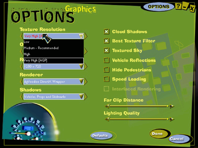

Reply 251 of 474, by Dege
kjliew wrote on 2020-10-14, 22:18:
Was the GDI text elements from pull-down menu legible in the "Option" with dgVoodoo2?
Hardly... see the attached image.
Btw, I didn't run it from the CD. For some unknown reason, the executable always loads ddraw.dll from the system folder. 😕
    64.01 KiB
    1979 views

You know that the text just looks bad because font smoothing is on in Windows right?
This is actually one of the things that are fixed by the compatibility database that breaks when you rename the exe. Which I found a bit weird, since there are other games with the same issue, that are in the Windows compatibility base without this fix. It's almost like it's an unmaintained mess that shouldn't be included in Windows. Well for retro PC games anyway, maybe the professional applications are given more attention.
Reply 256 of 474, by kjliew
ZellSF wrote on 2020-10-15, 15:25:
I think it is probably the problem with Wine. It was the same on Win98 VM with font smoothing disabled. All the texts are readable in Software Renderer mode regardless of font smoothing with the OS's copy of DDRAW. Software Renderer mode with WineD3D's copy of DDRAW also suffers that same problem. Anyway, having surface resources move back and forth between GDI context and OpenGL context is always troublesome.
Reply 257 of 474, by ZellSF
I was just talking about dgVoodoo, where it should look like this:
300.02 KiB
1974 views
(That screenshot is OpenMM1, but the unmodified executable looks exactly the same).
