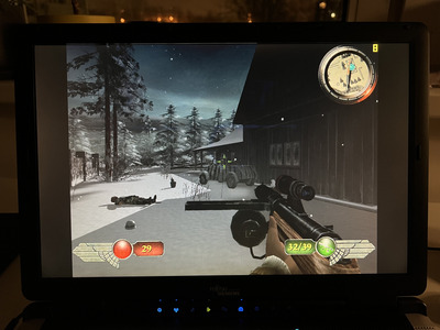

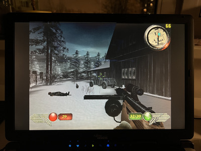

I'll just pop-up old thread. I'm playing Mortyr II on old laptop, but much more powerfull then sys req of it. And with dynamic shadows game runs at extremely low fps sometimes. It was always a buggy thing, or later pc's faced this issue?
