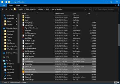

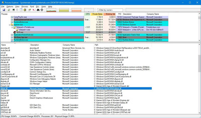

I am trying to use dgVoodoo with Age of Wonders. I copied D3D8.dll, D3DImm.dll and DDraw.dll from the x86 folder to the game's root folder, as well as the default CONF file and changed some settings. However, dgVoodoo was having no effect on the game. I opened Process Explorer and found that the reason for this is that the game isn't loading dgVoodoo's DLLs at all but is loading the system's instead:
227.25 KiB
1594 views
I'm trying to work out what I need to do to get the game to load dgVoodoo's files. The only thing I can think of is a similar problem that is noted in IndirectSound's readme; some game's load DSound.dll by querying it's CLSID. When that happens, Win8 and later gives the game the location of the system's DLL. I could try their solution in this case but I don't know what CLSIDs are used for DDraw.dll, assuming that is the problem to begin with.

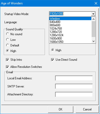

In the game's options, you can either select a fullscreen resolution or you can choose Windowed:

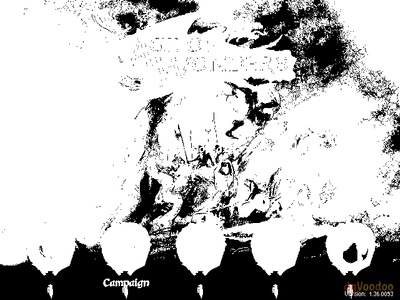

If I choose any resolution, the main menu looks like this:

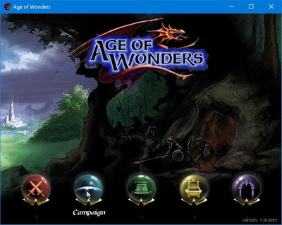

This is what it's supposed to look like, which I get by choosing the game's "Window" video mode. Strangely, the dgVoodoo watermark isn't appearing even though Process Explorer says that the game is loading dgVoodoo's DDraw.dll:

Reply 6 of 6, by XJDHDR
Dege wrote on 2021-07-14, 15:27:
What happens when you run the game through D3D12?
The problem seems to be the same as
https://github.com/dege-diosg/dgVoodoo2/issues/16
Sorry about that. My laptop has two GPUs in it: A low powered AMD GPU integrated into the APU and a discreet Nvidia GPU. Any games I play are supposed to run on the Nvidia GPU and this is what I assumed was happening. To answer your question: Running the game through DX12 fixed that problem. Conversely, forcing the game to run on the Nvidia GPU like it was supposed to also fixes the problem.
