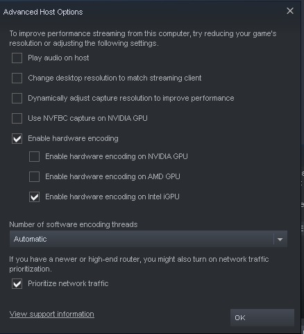

Feature Request/Check: Steam remote play
I was wondering if they are plans to support Steam remote play, or if it's already supported any tips/documentation to get it to work.
The attached image is just an example, I have other titles that do require dgvoodoo 2 to work and get the same results through Steam Remote Play.

Reply 176 of 237, by Aemony
It's probably more on Valve and Steam than on dgVoodoo, I imagine. Steam Remote Play has known issues with capturing video playback in some games as well, because it tend to work through whatever API/swapchain that the Steam overlay hooks, so when some videos gets played back "above" the hooked swapchain, it won't display anything, as an example.
It's probably something hook related here as well -- and probably something that Valve needs to fix since I believe their overlay ends up hooking the game after dgVoodoo has already done its thing.
Reply 178 of 237, by ECHOTRON
Dege wrote on 2022-06-30, 14:02:
TBH I know nothing about steam remote play... Is it something that need dedicated support from the application side? Or is it meant to "just work" with any D3D11/12/whatever game?
It doesn't require dedicated support and therefore Steam can attempt the feature with non Steam games if added to the library manually. Like what lowenz mentioned it just streams the application to a remote machine, and allows input from the remote machine.
The reason I asked if it's already supported is there is a lot of options available to adjust that I don't fully understand whether they would interfere with streaming an application running through dgvodoo 2.
Steam Remote Play Together does somewhat need dedicated support/certified to work but that's a separate feature.
Reply 179 of 237, by Dege
Thanks for you all for your replies. So, it's "just" a D3D11 output hook-and-stream. The dgV options only affect the internals of dgV rendering so it shouldn't conflict with the streaming. The D3D11 output itself is a plain swapchain presentation, nothing special.
