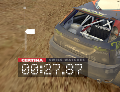

As we know texture resolution in old games can be pretty low and bilinear filtering which is used universally can look pretty bad in this situation. High contrast pixels when stretched a lot form this 4-pointed star look - see the attached picture for an example.
So my wish is an ability to replace it with a better algorithm. See this comparison:
Beetle PSX emulator already does this, allowing to use jinc2 algorithm.

Texture replacement has been requested a few times, if Dege ever implements that I'm guessing automatic texture replacement will be relatively easy. Maybe possible already using third party tools.
I really want normal2x/3x/4x/5x/6x like GZDoom has for older games. Keeping that pixelated look, without all that pixel crawling.
Reply 4 of 4, by Azarien
shortcat wrote on 2021-10-25, 07:20:
Just remembered one idea - upscaling textures using a "good" algorithm and then using then in the usual render pipeline utilizing bilinear filtering might be practical.
In OpenGL terms, shift all mipmap levels one point "up" and manually upscale level 1 (formerly level 0) into new level 0 using the best algorithm you can find.
That should do the thing while keeping the original texture data intact whenever upscaling is not needed.
