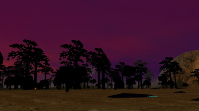

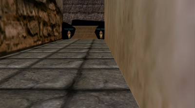

I installed dgVoodoo to solve issues of crashing when playing Everquest Project 1999 and it has really worked super good - not a single crash since I installed the 4 .dll files. Thank you!
But, small graphical bugs have been introduces in various zones of the games. Some objects are entirely black, and they brighten up a bit when I walk up to the them, as if there would be an issue with the lighting effect.
I attached two screenshots to show how it looks like.
When removing the 4 .dll files, the graphical bugs are gone, but I really would like to solve this so I can have dgVoodoo installed.
Thanks in advance for the help!

Hello and thanks for replying!
I cannot say if you will be able to produce it, but the only dgVoodoo files I have copied into my EQ1999 folder are:
D3D8.dll
D3D9.dll
D3DImm.dll
DDraw.dll
For example, one of the screenshots is from the East Cabilis zoneline to Field of Bone, where behind the two Trooper guards, are some very dark looking stones. When u get closer to those rocks, you can see there's a bit of dark blue tint in them, as if there would be something wrong with the way the light/reflections are being produced by the game (when having these .dll files in the EQ1999 folder)

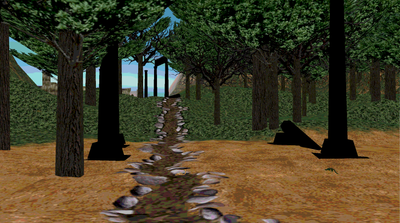

Reply 11 of 18, by scifo76
Here another example in East Commonlands, near the West Freeport border.

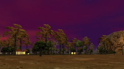

Reply 14 of 18, by Dege
I followed this tutorial:
https://www.youtube.com/watch?v=mj_MMVgJ_Dk
and installed the game. I chose this server:
I created 8 different characters and explored many landscapes but didn't encounter black objects. Everything look fine, like this:
So, either the bug only comes at your specific locations or I can't reproduce it.

Reply 16 of 18, by scifo76
I have found it!
In the very beginning of my eqclient config file, in the [Defaults] section, I had an entry like this:
HardwareTnL=FALSE
Removing this, the game looks great - NO issues.
For researching/geek purpose, can you try to reproduce it by adding that line in your eqclient config file, in the [Defaults] section? Would be interesting to see if you can reproduce it.
And, as a curious person I am, do you have any idea what that entry does to the game and how/why it collides with the dgVoodoo .dll files?
All the best!
Edit: Apparently, this command tells the game to not use the Hardware Transform and Lighting features of the video card. This entry is NOT included in the original eqclient.ini file of Project 1999, so it must have been added later, probably by myself when trying to solve some screen tearing issues 3 years ago.
Reply 17 of 18, by Dege
Thanks, that' s a nice find! Now I could reproduce and fix it.
Yes, disabled Hardware TnL (sw vertex processing) forces vertex shaders / FF pipeline to be executed on the CPU. As a "side effect", it also controls how (in what way) vertex (buffer) data is got copied to the video memory.
dgVoodoo never executes shaders on the CPU when they're invoked implicitly from the Draw calls but keeps compatibility by using sw vertex buffers (that's where I found a bug), so I don't recommend HardwareTnL=FALSE anyway.
