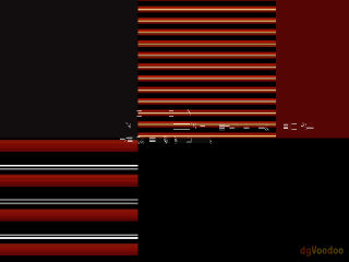

I was just trying to run an old 2D game through dgVoodoo on the HD3000 (said game was known to work on another PC with an nVidia card), and it turns out the game simply did nothing, it just went back to the desktop, no error message nor anything. Switched the output API to MS WARP and then it worked, although painfully slow...
Curious, I installed 3DMark99, 2000 and 2001SE; only to discover that none of them launched, giving these errors:
58.48 KiB
3451 views
The benchmarks run fine with dgVoodoo disabled, I just used them for reference since they're supposed to work OK with dgVoodoo, according to "DirectX demo gallery and my test results". This is on Win7 x86, using latest Intel HD 3000 drivers and dgVoodoo latest version, 2.77.

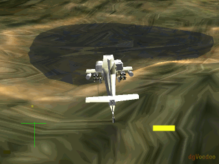

Then I switched to another PC with an Intel HD 4000 iGPU, and tried the same benchmarks, with these results:
1.34 MiB
3451 views

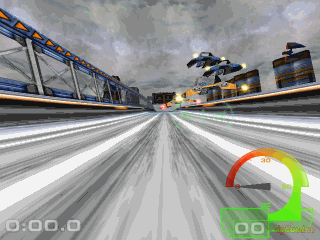

DX6.1 seems to work OK, no problems or anything, but when I moved to DX7 or higher...
1.44 MiB
3451 views
1.36 MiB
3451 views
This is on Win8.1 x64, using latest Intel HD 4000 drivers and dgVoodoo latest version, 2.77.
Next generation of Intel graphics (Gen8), the same thing as Gen7 happens: DX6.1 works, DX7 is glitchy, and for some reason 3DMark2001SE refused to launch: it just hangs. This was on another Laptop with a Pentium N3710 (Braswell), using Intel HD Graphics with latest drivers installed on Win7 x64. Also using latest dgVoodoo version, 2.77.
Is this the expected behavior with these old chipsets?
ADDENUM: 3DMark03 (DX9) seemed to work OK on Gen8, except for the benchmark loading screens prior to each test, which just displayed as white. Gen6 just errored like usual, with a "Direct3D initialization failed" message. Didn't had time to test on Gen7...
Reply 1 of 22, by Dege
Thanks for this extensive, well-illustrated report!
TBH, dgVoodoo should work on those chipsets. DX11 FL 10.0 is still supported in dgVoodoo, I just ran 3DMark2000/2001 through that on my Intel HD Graphics 505. It's Gen9 and this is the oldest Intel I have these days. They worked perfectly (Win10).
Yes, I mentioned Intel HD 2000 and 4000 amongst the tested GPU's. I started developing dgVoodoo on a HD 2000 with feature level 10.1 (2012) and things worked with a contemporary driver. I emphasize "contemporary" because newer drivers interestingly removed FL 10.1 support. Later I experienced broken things with newer drivers even with my NV GF 450 GTS. So, that's why I'm not a big fan of having the newest drivers for old GPU's. Btw, Intel HD 2000/4000 were mostly tested with Glide because the DX part of dgVoodoo did not exist at the time.
You may want to check out if older (pre-2.55.x) versions of dgVoodoo works.
So, what I can do on dgVoodoo side are:
- Checking out if the DX11 debug layer is complaining about something when running those demos at FL10.0 and FL10.1. If not, then it's something on the driver side (as the WARP renderer works).
- I realized that I could "simplify" a certain thing (resource usage) in the DX11 implementation since I ditched the HLSL compiler and precompiled shaders, so maybe it won't confuse even a dumb driver. I'll make such a build soon, we'll see, but it's just a guess of mine about this being the "problem".
Driver side:
- Checking out old drivers to see if thing is the same as with AMD drivers: old ones are working with the newest version of dgVoodoo.
When the demo doesn't even start and fails with an error message, that means that dgVoodoo cannot even initialize DX11 with the needed objects (you can have a look at dgVoodoo debug logs, but the interesting one would be the DX11 SDK layers). We had a really old AMD chipset (can't remember exactly what) having this problem: it couldn't create a certain DX11 buffer with arbitrary size so dgVoodoo failed. Unfortunately we couldn't figure it out what size it liked so the issue remained unsolved.
Reply 2 of 22, by unmei220
This was the key. I started with dgVoodoo v2.54, and suddenly everything worked perfectly on Gen7 and Gen8. The reason I didn't test v2.54 on these chips before was that I tested it on the HD 3000 (Gen6) first, and since it gave me the same results as newer versions (can't initialize D3D errors and so on, as mentioned before), I just thought it would be the same with the newer chipsets...
I started moving up from there and found out that the version that "breaks" compatibility with these older iGPUs (at least on Win7 & 8.1 x64) is dgVoodoo v2.76 (ATI TruForm support, specialized vs FF shaders, bugfixes).
Until dgVoodoo v2.75.1, everything worked perfectly.

Reply 4 of 22, by unmei220
Dege wrote on 2021-12-13, 20:09:
Oh, then it must be the new shader code generator...
What happens if you disable the DirectXExt\EnableSpecializedShaders for 2.76+? (compatibility option)
That did the trick!
God I feel dumb... I should investigate properly next time before posting walls of text...
So, there's no issues neither with Gen7 nor Gen8, while Gen6 refuses to work (old driver test still pending).

Reply 7 of 22, by Dege
Could you plz test WIP85 with HD 4000? (with DirectXExt\EnableSpecializedShaders set to true)
I looked at the shaders used in the 3DMark 2k helicopter test, and I had a strong guess what the driver didn't like.
I made changes to the code generator, it might help:

Both 3DMark2000 and 3DMark2001 SE worked without problems, no more glitches of any kind.
BIKŌ also started working smoothly. It takes like a few seconds of pause when switching, but no longer crashes when the resolution changes!

Reply 13 of 22, by Dege
Oh, yeah, its' entry #60. Then, there are no more options... 🙁
Structured buffers are essential in Glide and some of my DX shaders so I cannot remove them.
Those Intel drivers are strange because I started coding dgVoodoo2 on an Intel HD2000 and structureds buffers were supported (along with FL10.1) back then. Why did they remove the support for them in later drivers? 🤔
Reply 14 of 22, by unmei220
No idea...
As I said before, the older drivers designed for Vista and Win7 (win7vista_152254.exe/win7vista_64_152254.exe), 15.22.54.2622, dated 1/21/2012, work perfectly fine with DgVoodoo (but has errors in other areas).
Meanwhile, the newer ones designed for Win7, 8 & 8.1 (win32_152824.exe/win64_152824.exe), 15.28.24.4229, dated 6/5/2015... well, you know the rest.🙁 But they're much more robust and compatible than the older ones, specially with old games!
Thank you very much for your efforts! 😀
