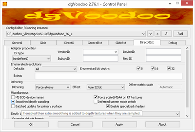

Dege wrote on 2022-05-12, 16:59:
lowenz wrote on 2022-05-11, 07:13:
Maybe it's time to enlarge a little bit the control panel window? […]
I didn't want to increase the size just because of a few options that are rarely used anyway. Wouldn't the CPL look elephantine?
how about just let people decide and not lock the resize 😉

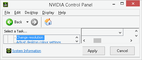

Reply 1 of 23, by robertmo
that's not just about enlarging but also about shrinking
for example nvidia's control pannel is operational even this big:
(useful for when you have desktop in very low res for testing (for example extreme high monitor refresh rates 😉)
    5.15 KiB
    1299 views
Reply 3 of 23, by robertmo
lowenz the window in its size is still operational in 640x480.
but you can try this
http://www.digitallis.co.uk/pc/ResizeEnable/index.html
start ResizeEnable
start dgvoodoo
close ResizeEnable
enlarge dgvoodoo wider a bit (by half)
start ResizeEnable again
enlarge dgvoodoo wider so that all is visible (don't use shrinking here!)
close ResizeEnable
shrink dgvoodoo so that it shows only the content
