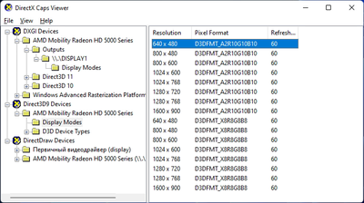

Have you tried Feature Level 10.0?
Reply 3 of 20, by Dege
At the point where the error message is dumped, D3D backend is initialized so it's not related to unsupported hardware or feature level.
- Does dgVoodooCPL show the resolution list as expected?
- Didn't you accidentally disable all resolution by setting option DirectXExt\DefaultEnumeratedResolutions to 'none' without defining any extra enumerated resolution?
Reply 4 of 20, by esasoft
Dege wrote on 2022-05-28, 10:34:
Yes, dgVoodooCPL shows the resolution list.
No, I didn't do anything like that.
Reply 6 of 20, by esasoft
The first debug log contains this string
7 0.017579 13308 Porsche.exe [dgVoodoo] INFO: Device 0: Name: "AMD Mobility Radeon HD 5000 Seri\\.\DISPLAY1", Description: "\\.\DISPLAY1", Monitor rect: (0, 0, 1600, 900), GUID = {67685559-3106-11d0-b971-00aa00342f9f}, system primary monitor
But the system name of the video adapter is AMD Mobility Radeon HD 5000 Series.
Could this be a problem ?
Reply 7 of 20, by esasoft
Dege wrote on 2022-05-28, 13:55:
Could you attach the config file?
Also, is this the only game with this problem?
Yes, of course. Here it is:
dgVoodoo.conf
17.82 KiB
43 downloads
No, dgVoodoo2 is not working at all, not only with these games.
Reply 10 of 20, by Dege
The phenomenon is like if you hadn't any display attached to the adapter output which is of course nonsense, the primary display is listed in the log. But honestly, that's the only case giving an empty resolution list.
What adapters do you have in the CPL 'adapters to use/enable' list? Also, if you select them one-by-one, do you get any display output (other than 'Default') in the 'full screen output' drop-down list?
Reply 11 of 20, by esasoft
Dege wrote on 2022-06-05, 07:58:
Under "Adapter(s) to use / enable" I have the following options:
All of them
Microsoft Basic Render Driver
If "Microsoft Basic Render Driver" is selected, I get only "Default" option, which, I think, is normal.

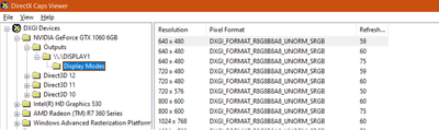

Reply 12 of 20, by Dege
Then plz download run DX Caps Viewer to see what outputs, resolutions and pixel formats it lists for the DXGI devices:
https://github.com/microsoft/DxCapsViewer/releases
Maybe the pixel format dgv is looking for (DXGI_FORMAT_R8G8B8A8_UNORM) is missing, or sg like that.
You should see sg like this:

Reply 13 of 20, by esasoft
DX Caps Viewer doesn't show any resolutions or pixel formats in DXGI section:
61.77 KiB
1412 views
There are resolutions in Direct3D9 Devices:
90.19 KiB
1412 views
Reply 14 of 20, by Dege
Then it must be something wrong at driver level. It can't enumerate the supported resolutions through DXGI for some reason.
Maybe the problem is Win11 itself. I don't know if AMD mobility radeon HD 5000 has dedicated Win11 drivers (I couldn't find one), and the Win10 driver might not be fully compatible with Win11.
