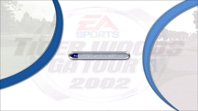

So this game only runs in GPUs with up to 128 MB of VRAM, I set that in dgVoodoo, the game starts normally, but then becomes stuck in this Graphics Hardware Test and doesn't go through it. Can anyone help me on this? I already chose every GPU on the DirectX list (game uses DX8), but nothing worked, tried to change vendor IDs in the DirectXExt section, nothing as well, I wanted to replay this classic game from my childhood.

It turns out to be a bug in dgVoodoo, altough it should cause a crash instead of getting stuck in the process.
Anyway, I fixed it but still there is a weird rendering glitch: when entering the golf scene, the sky is black through the camera-flyby. I think I have the original version of the game, any chance that this glitch was known and got fixed in a later game patch?
