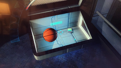

Game: Deus Ex - Invisible War
Issue: There is a double cursor / not disappearing cursor in the 3D rendered part of the game. It's fine upon loading the game, but the first time you go to load a UI element the cursor appears, but doesn't disappear once you exit the screen.
dgVoodoo2 stats: Working <= 2.7; 2.71 <= Broken => 2.79_3

Log Analysis:
After loading a save, it does a ShowCursor set to 0. The cursor is not present on screen (other than the center screen graphic). At 14 seconds in was when I was finally able to get over and click something. You can see a ShowCursor 1, followed immediately by a SetCursorPosition 1280 x 700. It shows ShowCursor 1 a few more times, but eventually shows a ShowCursor 0 @ 16.273729, which was caused by me exiting the ui menu. The cursor is not supposed to be present after that. The final ShowCursor 0 at 17.647371 is from me alt-tabbing out of the window.
I tried to capture as little logs as relevant to keep the log size down, however from going into the window multiple times, you enter and it does a ShowCursor 1 and the cursor shows up. When you exit it does a ShowCursor 0 and the cursor doesn't ever disappear after that. There is another game cursor, but I'm pretty sure it is just a reticle drawn on the screen, not an actual cursor as far as DX is concerned. ShowCursor 0 seems to be non-functional.

Edit: Further information discovered. With 2.70 changing ScalingMode from unspecified to centered_af will cause an identical issue. However with 2.79_3 it does it on ScalingMode unspecified as well.

Thanks for the donation and the extensive description for the problem! I'm sorry about checking this issue out and responding to it so late.
Yes, you're right, Direct3D8Device::ShowCursor with bShow = FALSE doesn't work as expected. In the older versions the device cursor implementation was kinda trash (problems with FFXI) so I rewrited that part from scratch. That's when this bug must have appeared in the code.
Now I fixed it and tested with all cases (hardware cursor, emulated cursor), and it works with this game. But of course, it should do it with others too. 😀
