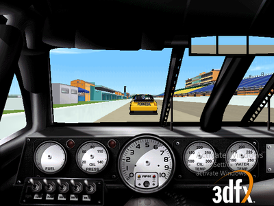

The car speedometer needle is missing in this game. I am using the max settings possible for graphics. The DirectDraw version is fixed it by changing the RHW value to 1 from infinity. Can you look into the same problem for this game's 3Dfx version? The problem is already fixed for dgV2's DDraw version.

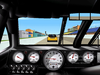

Additionally, I saw that if you bring the mouse near the 3Dfx logo, the screen around the area becomes pixelated. I also saw some differences in the graphics between nGlide and dgV2 with this game, most prominently look at the green pavilion on the left and the yellow seats on the right:
dgVoodoo2-
nGlide-
