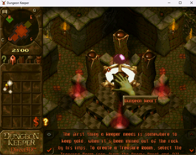

I know the Direct3D version is graphically inferior to the software version of the game, but I want to get all the classic versions of DK1 working on modern systems.
The software version works okay (but only launches if it's on the C drive for some reason), but Direct3D seems to have issues when it attempts to load a level.
It works fine in the menus and overview screen, but once you try to load a map, it will show the loading disc screen for a moment and then crash to the desktop. No errors messages or anything. I've tried this both with dgVoodoo2 and native D3D, and neither seem to resolve the issue.
Does anyone know of a solution for this? If there isn't a solution currently, could anything be done with dgVoodoo's development to accommodate this version of the game?

EmulateHeap shim (broken in Win11 22H2) or DxWnd's Handle Exceptions flag both work.
Fake fullscreen is also recommended.

Well both dgVoodoo2 and DxWnd have the D3D problem sorted out. dgVoodoo2 usually works with DxWnd, but I never both together in the game. The crash problem was fixed with DxWnd. You might visit the SF thread of the game for more details.
I don't know if EmulateHeap creates problem with the game. I recall there's one of the game, Keeper or Deeper (Ddraw or D3d version) that doesn't launch unless exe is renamed or Hook/NoShims (DxWnd) is used (your C drive bypasses this issue). This is because the game tries to read "short pathnames", not available by default on Win10/11. By doing this, EmulateHeap was disabled along with the problematic shim in this case. This proves the game crashing could be fixed by enabling Handle Exceptions +/- Emulate Heap.
Oh and if you intend to play in real fullscreen, be ready to have 320x240(or 200) desktop resolution ready in graphics driver.

Set DirectX Version Hook to None in the DirectX tab in DxWnd and DxWnd won't touch DirectX rendering.

Just checked. With DxWnd, Keepd3d.exe needs Handle Exceptions and Support Offscreen 3D tweaks to be enabled. Also I enable InjectDll hook for best hooking.

Also just checked keeperd3d. Needs the exact same settings.

Looks like making a new profile from scratch seemed to work. Is there any way I can have DxWnd automatically initialize by launching the EXE directly? Or is that something I can only do through the DxWnd launcher?
