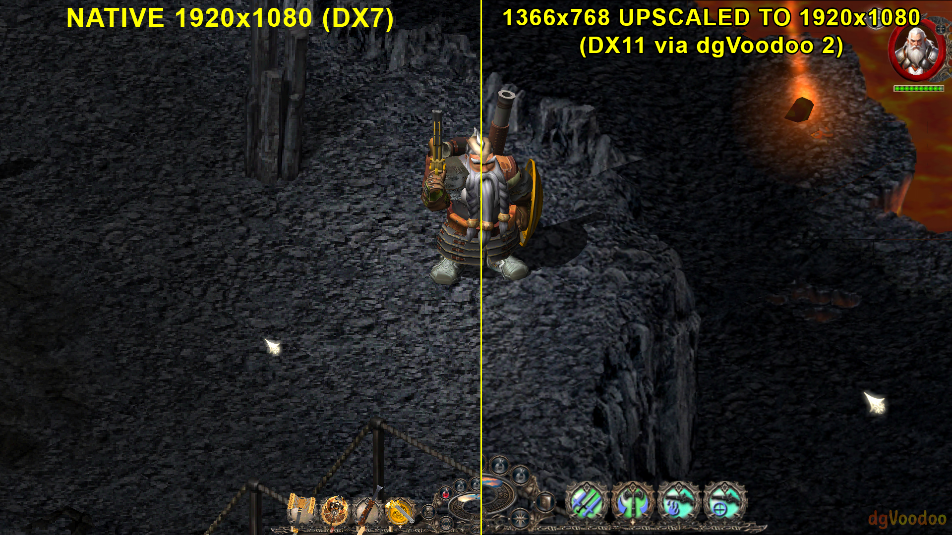

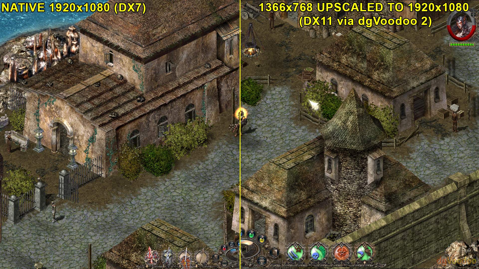

Here are a bunch of screenies pitting a pixel-perfect, native 1920x1080 DX7 output without dgVoodoo against a 1366x768 output upscaled to 1920x1080 with the above listed dgVoodoo tricks:

Of course a static picture won't tell you how much easier on the eyes world scrolling becomes with dgVoodoo, nor will it give you any idea of how bad the random tile jitter is without dgVoodoo, let alone the overall shimmering while zoomed out and moving...

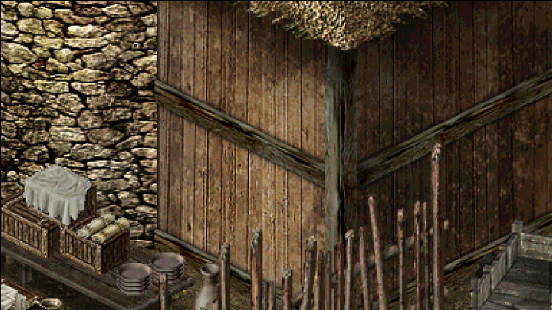

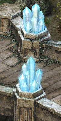

What's your problem then, you may ask. Here's the deal, there's one bug that dgVoodoo sort of exacerbates.
Without dgVoodoo, a small bunch of tiles throughout the world get these ugly seams at resolutions above 768p: https://i.postimg.cc/h4kfSH12/seam.jpg
With dgVoodoo, the moment you set Filtering = 16 (or any other value besides app-driven, for that matter) the seams become much less noticeable, but they start popping up even at 768p in crazy numbers all across the game world: https://i.postimg.cc/1XwwK6QF/seam2.jpg
Forcing a custom filtering mode in dgVoodoo is vital to resolving the worst issues with the game engine (including the utter lack of filtering that has always been endemic to this game). Just switching it off brings back a lot of problems. Switching it on trades all those problems for one new, much less annoying, problem that still prevents the game from looking nice.
