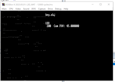

IMO this should work, but, as you can see in the attached image, the whole thing is a mess of vertical lines.
I'm thinking that CGA memory does'nt work like I think it does and it would be awesome if someone here
could give me a hand to fix this as I've tried many things and nothing works...

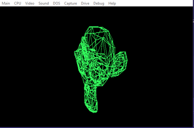

I've attached an image of what it should look like (the blender suzanne monkey being rasterized),
and what it looks like when using my video buffer technique, a garbeled mess...

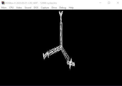

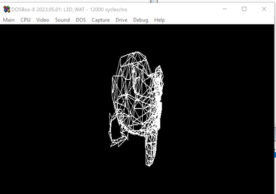

Hi,
FIrst of all a big thanks for writing this for me, it's highly appreciated! 😀
I tried it out, and it works, but, there are some interleaving artifacts,
check out the attached screenshot...
Any idea what that might be and h0w to fix it ?
No worries. Yeah, I was expecting my code to have some issues. Can you share your code so we can have a closer look?

Great, It works %100 now 😀
See the attached image of suzanne (the blender monkey primitive) 😀
It's got approx 450 polygons and I'm getting about 3 FPS on a 80186 @ 16MHz (My 200LX palmtop with doublespeed crystal installed)
I've still many things to optimize, such as transforming every float uses in the render loop to fixed point integers,
and I can also shave off one or two matrix transforms by combining them.

int offset = (y * (SCREEN_WIDTH / 8)) + (x >> 3);
// Add the pixel byte offset to the back buffer address (offset within the buffer).
buffer += offset;
// Read the buffer byte and shift the pixel bit into the right position and OR together
*buffer |= (0x80 >> (x & 7));
void back_buffer_clear(unsigned char far* buffer)
_fmemset(buffer, 0, sizeof(char) * ((SCREEN_WIDTH / 8) * SCREEN_HEIGHT));
void back_buffer_copy(unsigned char far* buffer)
int y;
// Have two pointers, one points to the start of the even scan lines
// the other points to the start of the odd scan lines.
unsigned char far* video_even = (unsigned char far*)0xb8000000L;
unsigned char far* video_odd = (unsigned char far*)0xb8002000L;
// Copy the buffer to video memory by alternating each scanline. First
// copy a scan line to even video memory, then the next to odd video memory.
for (y = 0; y < SCREEN_HEIGHT / 2; y++) {
_fmemcpy(video_even, buffer, SCREEN_WIDTH / 8);
video_even += SCREEN_WIDTH / 8;
buffer += SCREEN_WIDTH / 8;
_fmemcpy(video_odd, buffer, SCREEN_WIDTH / 8);
video_odd += SCREEN_WIDTH / 8;
Show last 59 lines
// NOTE: Only draws lines from top-left to bottom-right!
void line(unsigned char far* buffer, int src_x, int src_y, int tgt_x, int tgt_y)
int diff_x = (tgt_x - src_x);
int diff_y = (tgt_y - src_y);
int err = 0;
int x = src_x;
int y = src_y;
while (x < tgt_x) {
pixel_set(buffer, x, y);
err = err + diff_y;
if (err >= diff_x) {
y++;
err = err - diff_x;
x++;
void main()
// Allocate the back buffer
unsigned char far* buffer = _fmalloc(sizeof(char) * ((SCREEN_WIDTH / 8) * SCREEN_HEIGHT));
// Set graphics mode 640 x 200 (1 bpp)
mode_set(6);
// Clear the back buffer.
back_buffer_clear(buffer);
// Draw line from top-left to bottom-right.
line(buffer, 0, 0, SCREEN_WIDTH - 1, SCREEN_HEIGHT - 1);
// Copy back buffer to the screen
back_buffer_copy(buffer);
// Loop indefinitely until ESC
while(1) {
if (kbhit()) {
int key = getch();
// 27 = ESC key
if (key == 27) {
break;
// Set text mode
mode_set(3);
// Release back buffer
_ffree(buffer);
To compile use the same command I showed earlier.
Good luck!
PS: Source of the line drawing algo I used: https://www.it.uu.se/edu/course/homepage/graf … gon/x_lines.htm

Reply 17 of 18, by radiance32
pan069 wrote on 2024-05-04, 23:29:
radiance32 wrote on 2024-05-04, 23:07:
Fantastic! Glad it works. The screen shot looks great. Good luck with your project!
Thanks again 😀
Another question,
I'm developing this for my 200LX, which has a very wide screen,
so the 640x200 mono CGA mode has square pixels on it's LCD,
but, on a PC monitor, this mode is displayed streched out vertically,
eg one pixel is two pixels vertically.
Since I''m using DOSBOX to test everything while I develop,
is it possible to configure DOSBOX to use an alternative aspect ratio,
so I can run my CGA HIRES app in DOSBOX with square pixels on a wide screen ?
I've searched through the DOSBOX configuration options and can't find anything...
Cheers,
Terrence
