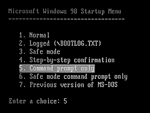

haker120 wrote:
I have an idea but I have no idea how to do it. Now I have win98SE on HDD and DOS6.22 of
floppy (on USB in gotek) and my question is, how to make DOS to see HDD and CD drive?
It's been a while since I did such things, so I can't give any advice how to add DOS subsequently.
It's important, however, that the HDD is set up with a FAT16 file system (use FDISK, then FORMAT C:).
Adding CD-ROM Support for IDE/ATAPI drives isn't hard. Just add:
Autoexec.bat
MSCDEX /D:MSCD001 /L:D
Config.sys
DEVICE=C:\DOS\VIDE-CDD.SYS /D:MSCD001
MSCDEX is part of DOS 6.x and VIDE-CDD.SYS can be found online.
haker120 wrote:
And is it possible to run win98 from DOS when I'd like to swap between them?
No. But Win98 setup will create an entry in the startup menu, if it finds MS-DOS on your HDD. 😀
It looks like this:
8.81 KiB
491 views
See also http://thpc.info/how/bootmenu9x.html
Edit: By "no" I mean MS-DOS 6.22. You can run Win98 by entering "WIN" in DOS 7.x, of course.
