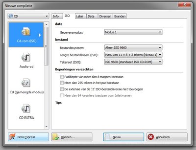

Reply 7 of 7, by Liveandlearn
Nero 10:
Mode 1
Only ISO 9660
Max of 11 8+3
ISO 9660
untick all boxes below that.
I just drag and drop. It gets rid of any name settings other then 8+3.
When files are messed up with names (had problems in the past).
I burn an iso with my files makes them word again 😁
included a screenshot
    94.84 KiB
    180 views
