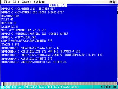

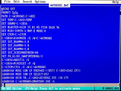

Pentium 133, 32MB system with MS-DOS 6.22. Config.sys and Autoexec.bat as below:

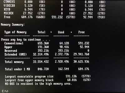

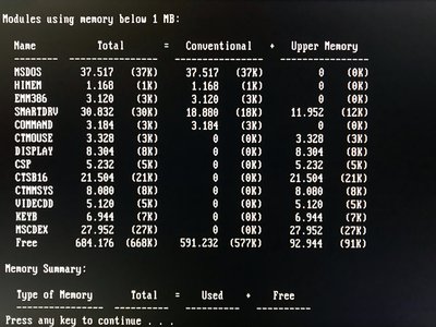

Mem /C /P reports the following:

Why can't I get DOS to load into HIGH or UMB? I really need the extra conventional memory for some games..

OK, so I had some pretty dumb mistakes in there; I shouldn't have had the SMARTDRV device in config.sys, that's a legacy driver from DOS 5.0 apparently, deleting that and removing the /L switch from the AUTOEXEC.BAT command got me up to 596K.. However, DOS is still in lower memory, and I can't figure out why..

Check driver and TSR load order

I also never succeeded loading high DOS 6.22 or the 7x win98se one but I do get more than 610kb of free base memory in my setups. I just use uram or the last byte or umbpci to create umb ram.
For your p1 use umbpci and a xms config, see how that goes.

1. The DOS=UMB command does not specify that DOS itself should be loaded to UMB. DOS cannot be loaded to UMB. Instead it specifies that DOS should manage UMB's so you can load device drivers and TSR's to UMB's.
2. The DOS=HIGH part specifies that some parts of DOS should be loaded to high thus freeing conventional memory. As you can see it works since you get the message 'MS-DOS is resident in the High memory area' as the last line of MEM command's output. Without DOS=HIGH working you would get at least ~60k occupied by DOS from conventional memory and you would get the message 'The high memory area is available' or 'HMA is not available' instead.

My question though is, why does my DOS have such a huge memory footprint (38K) while some people's DOS footprints are in the 9K-18K range? What is bloating the amount loaded into Conventional Memory?

Files, buffers, lastdrive, stacks, all those and similar add to the "MSDOS" entry. REM them out temporarily to see the difference

"MS-DOS is resident n high memory area" at the last line of MEM output means that you already successful about loading MS-DOS in ..well, high memory area. 🤣
I suggest using MEMMAKER. It sets my systems up generally better than what I can manually do. With all those extra commands like stacks, files, shell, last drive etc, it is not that uncommon to have a larger foot print.

I don't think you have seen 9k footprint in case of regular DOS like DOS 6.22 . It's more likely that was Win9x (DOS 7x). Win9x's DOS part can load command interpreter and big part of the system to UMB's (if UMB's are provided with either EMM386 or UMBPCI). You can notice if this is the case since the MEM command lists 'SYSTEM' instead of 'MSDOS' as the first line and you can also see the 'SYSTEM' and 'COMMAND' parts occupy some upper memory.
Also DOS=HIGH is the default in case of Win9x. You have to specify DOS=LOW if you want to test Win9x's DOS part not loaded into high memory area.

Memmaker cannot help here since basically all your drivers are loaded to UMB's already and you have still plenty free upper memory. Memmaker cannot do more.

As I wrote it's definitely the buffers, files, stacks, lastdrive, but not only. The environment space (command.com /e:xxx) is double the default for example, although I see you probably need it with so many SETs. Even maybe country.sys.
You need to play a bit with those, obviously not with things like a cdrom driver that are clearly loaded high. REM/disable a line or change a value, reboot, check the effect on MSDOS weight. You'll be surprised. 🤣 Then you can decide what to keep and with what values.
Edit: If you want to take the short path, just remove the buffers=40 line... That'll save you around 20KB from MSDOS entry
Reply 12 of 20, by appiah4
Thanks for all the feedback, reducing buffers to 10 and moving SMARTDRV after MSCDEX did the trick and now I have 605K conventional memory free, and only 17KB for MS-DOS in conventional memory, which should be plenty enough for even more demanding games.

Just a nitpick that I just realized: MODE is not resident so no need for LH as far as I can remember (and LH is enough, no need for loadhigh 😊 )
It's a matter of taste of course, but I also suggest ncache and ndos (from Norton Utilities 8.0) instead of command.com and smartdrv, their conventional memory footprints are considerably less than their MS-DOS counterparts.
