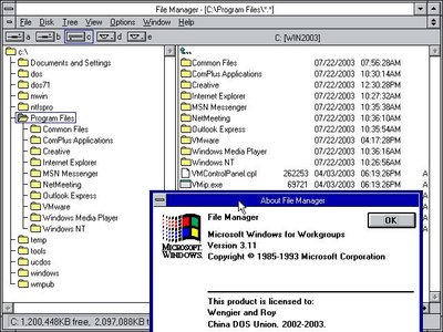

Just use MS Dos 7.1. You'll use to need need to run Win3xStart.exe to run Win3.x on MS Dos 7.1 drives.There is a replacement File Manger with FAT32 support. I also thing there is a version of Calmira 3 with LFN support built in.
Pic of Win 3.* FM sfowing LFN

The likes of Instant File Access and modded File Manager certainly prove MS ware telling fibs about win3.* accessing fat32 drives. A bit like the tale that NT 4 couldn't access usb thumb drives.
