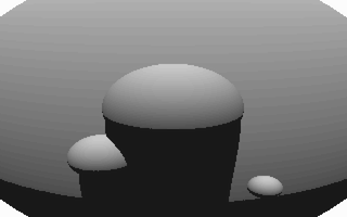

I done real time ray-traced clock with shadows for 386 plus 387 fpu or compatible CPU with VGA card.
Can somebody here check it on real hardware and capture it on video for me to use , please?
Use any assembler that can output plain binary image.
Then use it as boot sector for floppy disk.

db 010h ; num-B-in-ator a byte code interpreter by Estece in 512-byte boot sector version 2020 July second
db 040h ; -----------------------------------------------------------------
db 000h ; You need a 386 cpu & 387 coprocessor (FPU) or compatiblile
db 000h ; Program starts in data entry mode and You may turn off caps lock then:
db 0C0h ; Press a key 0,1,2,3,4,5,6,7,8,9,a,b,c,d,e,f to put high 4-bit part (H) of a data byte.
db 03Fh ; Press a key 0,1,2,3,4,5,6,7,8,9,a,b,c,d,e,f to put low 4-bit part (L) of a data byte, then a byte represented by
db 0CEh ; both parts (H0h or 0Lh = HLh) will be placed in memory at adress 08000h and pointer will be advanced to the next byte.
db 0FAh ; You can decrement pointer by 1 when You press once a backspace key.
db 000h ; To switch to code entry press an 'm' key.
db 000h ; In byte code entry mode You may check if You shift key isn't stuck then :
db 001h ; Press a key 0,1,2,3,4,5,6,7,8,9,a,b,c,d,e,f to put high 4-bit part (H) of a byte code.
db 000h ; Press a key 0,1,2,3,4,5,6,7,8,9,a,b,c,d,e,f to put low 4-bit part (L) of a byte code then a byte represented by
db 000h ; both parts (H0h or 0Lh = HLh) will be placed in memory at adress 07E00h and pointer will be advanced to the next byte.
db 000h ; You can decrement pointer by 1 when You press once a backspace key.
db 03Ch ; To swich to data entry mode reboot or power off your machine. All data will be lost forever!
db 000h ; To swich to execution mode press a 'g' key and see if You fingers are numb.
db 000h ; If You typed correctly num-B-in-ator will execute Yours byte code.
db 000h ; These are byte code instuructions that num-B-in-ator can execute:
db 010h ; 3ch XXh - call procedure at byte code pointer (BCP) plus XXh signed byte offset , no recurse allowed,
db 00Eh ; no nesting allowed, no parameters allowed
db 000h ; 41h - return from procedure called by above byte code , no results returned
db 000h ; 36h XXh - jump to byte code pointer plus XXh signed byte offset
db 0C0h ; 2eh XXh YYh ZZh - jump to byte code pointer plus ZZh signed byte offset IF float at unsigned byte data pointer XXh
db 0A8h ; is above float at unsigned byte data pointer YYh ([XXh]>[YYh] if true then jump BCP+ZZh)
db 000h ; 52h WWh XXh YYh ZZh - add an unsigned integer (word 16-bit) pointed by unsigned byte data pointer XXh to
db 000h ; an unsigned integer (word 16-bit) pointed by unsigned byte data pointer WWh then
db 0DBh ; compare a signed integer (short 16-bit) pointed by unsigned byte data pointer WWh with
db 0E3h ; a signed integer (short 16-bit) pointed by unsigned byte data pointer YYh and if
db 0B8h ; greater jump to byte code pointer plus ZZh signed byte offset
db 000h ; ([WWh]=[WWh]+[XXh] then [WWh]>[YYh] if ture then jump BCP+ZZh)
db 0A0h ; c6h XXh YYh ZZh - add a float at unsigned byte data pointer XXh to a float at unsigned byte data pointer YYh
db 050h ; then store result in a float at unsigned byte data pointer ZZh ([XXh]+[YYh]=[ZZh])
db 00Fh ; 8bh XXh YYh - change sign and store float at unsigned byte data pointer YYh from
db 0A1h ; a float at unsigned byte data pointer XXh ([YYh]=-[XXh])
db 0BBh ; 84h XXh YYh - copy a float at unsigned byte data pointer XXh to
db 000h ; a float at unsigned byte data pointer YYh ([YYh]=[XXh])
db 080h ;
db 031h ;
db 0FFh ; 7fh XXh YYh ZZh - divide a float at unsigned byte data pointer XXh by a float at unsigned byte data pointer YYh
db 031h ; and store it at a float at unsigned byte data pointer ZZh
db 0C9h ; no check for zeros at [YYh] ([ZZh]=[XXh]/[YYh]) "crash and burn" if [YYh]=0!
