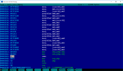

I'm not sure about all Quake3 versions but the original 'Quake 3 Arena Demo' (exe size: 864 313 bytes) does not contain any MMX optimized code (only large chunks of x87/FPU heavy code).
It's rather easy to check this with BIEW or any other binary viewer that has disassembly option.
MMX instruction blocks have to end with EMMS instruction because the MMX registers are mapped onto the x87 stack. The hex code of EMMS is 0x0F77 so it can be searched.

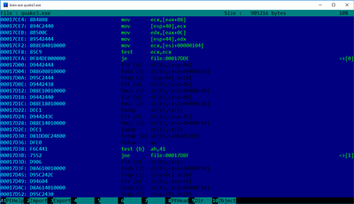

I am using Quake 3 Arena v1.32, which isn't the demo version. Anyway to disable MMX support entirely in this version of Quake 3?
I have just checked v1.32 (exe size: 905 216 bytes) and it does not conatain any MMX code either... So you simply do not have to disable MMX support since no such optimizations contained in executable.

If exe contains MMX optimizations EMMS instruction always can be found (it looks like this):
62.54 KiB

But in Quake3.exe you can only find standard 386+ and x87/FPU code. With PageDown you can quickly scan the code for 'white' parts (white means P5MMX instructions) but you will find none :
65.46 KiB

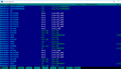

Allegedly there's MMX in 1.27g (an alternative 'nommx' binary exists) so maybe they've had issues. The released source references MMX only on two memory copy functions, MMX possibly only used for the linux builds.
I can confirm this. v1.27g really contains MMX instructions, but only move instructions:
65.92 KiB
345 views
@feipoa:
So your test is easy: If problem is MMX related then it should be experienced with v1.27g and not with v1.32.
