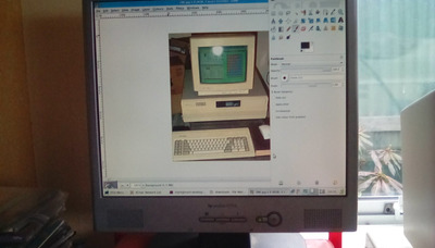

I can confirm Lubuntu 10.10 runs on a i586 system. AMDK2-6 400 256megs of ram. The install took 40mins. And when up and loaded LXDE is very responsive with the OpenBox window manager. I'll try out a couple of other DEs/WMs on it and post the results in this thread.

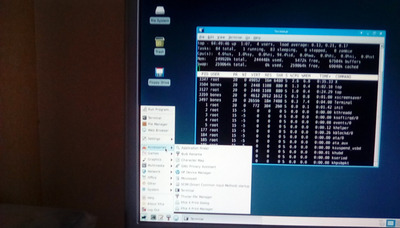

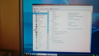

Lubuntu 10.10 installed and runs on my AMDK6-2 400 rig just fine. It also loaded and ran an old hdd I ran CrunchBang on a Celery 2.8GHz system with 2gig of ram. Slow loading up but once the desktop was loaded it runs fine. I even opened a picture in Gimp without bother. Now this system only has 256megs of ram as opposed to 2gig. That had me gob smacked.....Thought I'd wiped the hdd years ago.

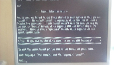

In the process of installing Slackware 13 using the huge.s kernel which can be used with a 486. If that goes well I'll give Slackware 14 and the latest 15 a shot.

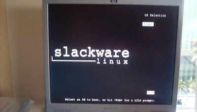

Well that went way way better than the last time I gave it a shot around four or more years ago. Very straight forward I deselected all KDE fluff and used xfce4. There are a few other light weight xorg desktop options available if you want to use them. Everything is as snappy as it is with other distros I've tried. Around a minute and a quarter to the desktop including logging in and running startx from the cli.
