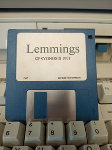

Is this a fake Lemmings disk?
First post, by wrexroad
I recently was given a container of floppies and found this Lemmings disk. It looks like someone tried really hard to make a commercial disk, but just ended up using a boring font instead of the real graphic. I thought it was interesting that they even went to the trouble of getting the part number lined up at the bottom and perfectly aligned label. The box is full of shareware releases of games, but this appears to be pretending to be a real copy. Was Lemmings ever released by a different publisher that would have used a only slightly different label? Just thought it was strange.
Reply 1 of 21, by NewRisingSun
Is the keydisk's copy-protected track intact? Meaning, does an unmodified copy of the game, installed to hard disk, recognize this disk as an original disk when you run the game (and no RUSSELL.DAT file is present in the hard disk's Lemmings directory)?
Reply 2 of 21, by cyclone3d
Might be an OEM copy that was included with a soundcard or something.
Yamaha XG repository
YMF7x4 Guide
Aopen AW744L II SB-LINK
Reply 3 of 21, by wrexroad
I don't know anything about copy-protection or Lemmings, but this is what I tried:
When I do a fresh install of the game there is no RUSSELL.DAT file and the game insists that I insert the disk for it to start. Then if I put the disk in it will load the game and create a (hidden) RUSSELL.DAT file and subsequent attempts to load the game no longer need the disk. Is that what you would expect?
Other oddities about the disk:
1. The disk label is garbage. I tried to correct it, but the computer refused (maybe that is part of the copy protection?)
2. I tried to mount it on my linux computer using a USB floppy drive and it couldn't read it. Putting it in my 720k drive on a real DOS computer works just fine.
3. I initially tried to run the game using the "CGA" and "IBM PS/2" options because I'm running it on a IBM PS/2 with the onboard MCGA graphics. The game will load the main screen and credits will scroll, but any keyboard input causes the whole computer to hang. Running it using the "CGA" and "PC Compatibles" mode, however works just fine.

A lot of USB floppy drives can't deal with 720kB disks. So the failure with the USB floppy drive might be unrelated to this specific disk.
If you are talking MCGA, you are talking about a PS/2 model 25 or PS/2 model 30. These computers are mostly highly integrated and slightly improved XTs.
The "real" PS/2 stuff with MCA bus and level-triggered interrupts starts with the PS/2 model 50. It seems plausible that the PS/2 mode of Lemmings is targetting the MCA models.

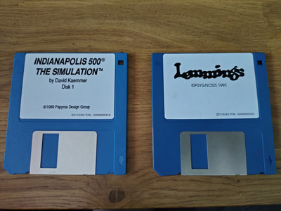

jmarsh wrote on 2021-03-06, 02:10:
Yes it looks like a bundled sound blaster copy. Was there an Indianapolis 500 disk in there too?
There is! No creative driver disks, but I'm guessing they were lost to time.. I guess that is mystery solved, thanks!
Reply 8 of 21, by megatron-uk
I believe my Indy 500 and Lemmings disks came bundled in with a Sound blaster 2.0 boxed set:
1.71 MiB
2478 views
At least I think that's where they came from - I can't remember getting boxed versions of those two games.

Reply 9 of 21, by NewRisingSun
wrexroad wrote on 2021-03-05, 23:46:
Yes, that is the correct behavior. Though for independent verification, you would use a different Lemmings disk from a verified source (i.e. with a more expected disk label) to install to hard disk, then use the questionable Lemmings disk as a Key Disk when prompted to do so, and not install from the questionable Lemmings disk in question. Because suppose that the questionable Lemmings disk was a bootleg copy, it could have been cracked to fake-success the keydisk check. The most common unmodified version of VGALEMMI.EXE has a CRC32 of 8458C7C6 and a 1991-07-19 date, so if the disk in question works as a key disk and this file has that unmodified CRC32, then it would seem to be an original copy in terms of the copy protection scheme.
Reply 10 of 21, by wrexroad
I'm pretty convinced that this is an original disk. I saw another report saying that the copy protection creates a garbage disk label. I also tried having an unrelated floppy in the drive and that didn't work, so if it's a fake copy protection, it's more than just checking for a disk in the drive. The fact that my USB floppy drive can't read it indicates that there is something non-standard about it. Someone mentioned that USB floppy drives have trouble with 720k disks, but this drive in particular is one that I use routinely to read/write data on 720k disks (i.e. not 1.44M disks that have been formatted as 720k). All together it seems like an awful lot of work to create a bootleg version of a game only to not even bother with the correct label.
I am curious about checking the CRC32 though, can you point me to a program that will calculate that for me? I would do the test with a verified Lemmings disk, but I don't have one and I think tracking one down is a bit beyond the scope of what I'm willing to do.

Reply 15 of 21, by NewRisingSun
I dispute that "the real" 3.5" version supposedly wants the keydisk every time. VGALEMMI on 5.25" and 3.5" disk is the same file, so it must behave the same. It's possible that the poster had a different VGALEMMI.EXE on his 3.5" disk, possibly earlier than 1991-07-19, that was stricter in this regard. But that is then a question of game version, not disk type.
Reply 16 of 21, by megatron-uk

https://www.target-earth.net
