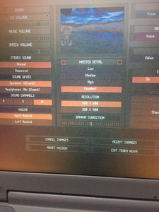

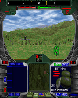

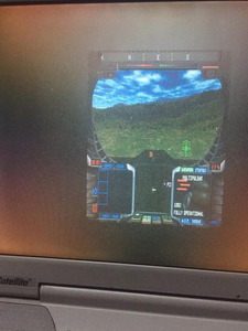

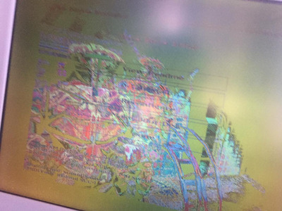

Terra Nova have some coloring issue in Toshiba Satellite 225CDS running Windows 98, what should I do?

Reply 1 of 9, by Hezus
If you're running it straight out of Windows 98, then exit Windows first and run it from the DOS prompt. This might help.
If I recall correctly, Terra Nova uses UNIVBE, so take a look here and try one of the solutions there.
Visit my YT Channel!
Reply 2 of 9, by Muz

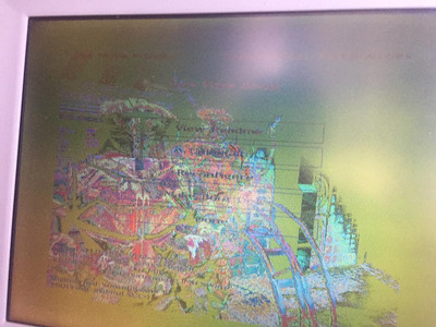

If I turn UNIVBE off, the video and the game runs well, but the color for the menu, navigation are like 16-bit, like the above.

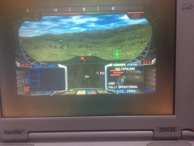

Okay, I've run the UNIVBE from the downloaded link, now when the screen is at 320 x 200, the screen looks like a vertical glass, but for 320 x 400, the screen looks normal.

Reply 4 of 9, by chuky

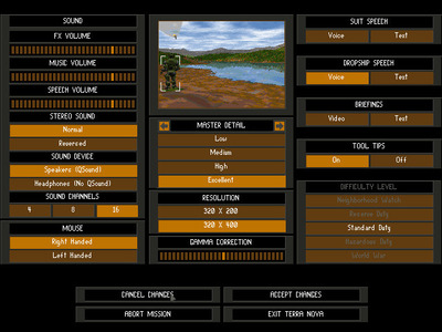

Does this happen with other games in 320*200 ? Did you try with an external monitor ? It looks like the laptop monitor does not upscale this resolution, or at least it displays a low resolution and puts black bars.
Reply 5 of 9, by leileilol
The readme's got advice about this happening on Matrox cards, which may also possibly apply here as it is the same phenomena
 2) If you have a Matrix MGA Millenium, run
Terra Nova WITHOUT INSTALLING UNIVBE and with
the +BADPALDAC switch.
long live PCem
Reply 6 of 9, by Garrett W
Terra Nova produces similar results with Voodoo 3 and I suppose Banshee and V4/V5 cards. I used the VESAFIX utility to alleviate this. Swaaye in the link above mentions that it might work on other, non 3dfx cards such as the GeForce FX 5950.

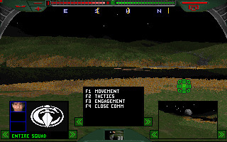

Here are screenshots from the game when pressing print-screen in DOS...

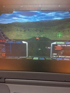

Reply 8 of 9, by Muz
Garrett W wrote on 2022-12-15, 07:28:
Thanks for the VESAFIX suggestion, Terra Nova now looks nice in 320x200 for now...
