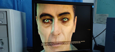

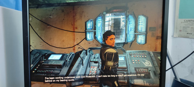

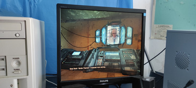

Is there a way to rollback to v5377866?
Edit: I rolled back to the previous build through Steam and now it works!
Anyway, thanks for the help 😀

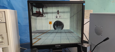

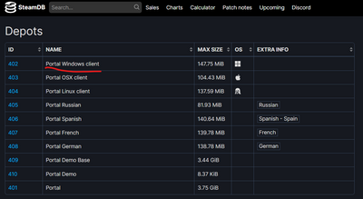

Now I'm having issues with Portal, because there's no previous build option for this game.
I've tried downloading the 2014 build with this method: https://steamcommunity.com/sharedfiles/filede … /?id=2353930763 and placing it in the Portal directory but it did not work.
I believe the cause are the dll files inside bin, which are missing from the depot.
Edit: I just needed to download the Windows client depot, which contains the required bin files.
Now It works flawlessly!
