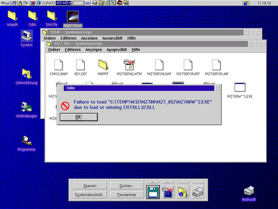

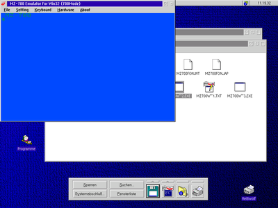

I'm currently trying to backport certain Win95 programs/emulators to Win32s.. Which to my surpise, really kind of works! Yay! 😁
- Once the relocation tables are installed and crtdll.dll is being used, things start to come alive. Cool!
However, there's one problem: Some Win 95 applications depend on early DirectDraw (DirectX 2 or 3) and DirectSound.
While DirectSound is used as nothing more as an MCI alternative, the graphics stuff is more complicated.
Converting everything to WinG is quite some work.
Hence my question - can a subset of DirectDraw be implemented on Win32s ?

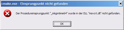

Just got an error message when trying to compile Pal-DDraw as an ordinary DLL (not for Win32s):
It complains about "cannot find entry point" error regarding _mkgmtime64 in msvcrt.dll.
Another user reported it here: https://sourceforge.net/p/mingw-w64/bugs/323/
I'm afraid I have to set up a VM with a more recent copy of Windows for such development software..
Hopefully, the produced binaries will run on Windows 95, at least, as promised.

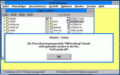

Reply 5 of 21, by Jo22
On the other hand.. Win32s seems to be quite forgiving, which gives hope for further experiments.
Copying the pseudo DirectX 3 runtime files from NT 4 SP6 over to \SYSTEM\WIN32S partially worked (in quotation marks).
The Win32s test application nolonger complains about DirectDraw being missing.
It's rather Win32s that seems to be a bit helpless, because it doesn't feature a vital function call (understandably).
"RtlFreeHeap" is an NT function that's simply not available.

Reply 18 of 21, by Jo22

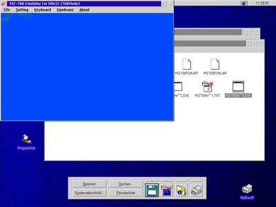

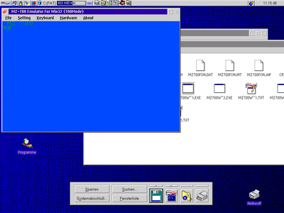

This is interesting! Odin (o.8.9) on OS/2 Warp can execute the MZ700WIN* binaries (Win32 EXEs)
with the MSVCRT dependency just fine (my compile with an relocation table and the original file),
but has trouble with the CRTDLL legacy version of my compiled binary.
Apparently, the latter library is not part of Odin, despite the existence of an alias for a "CRTDLL32.DLL".
When I borrowed the DLL in question from NT 3.51 and stored it as CRTDLL32.DLL in ODIN\SYSTEM32, it worked fine.
The other related files Odin has included are: Msvcirt.dll, Msvcrt.dll, Msvcrt40.dll..
Msvcrt20.dll is missing, too, which was used by Visual C++ 2.0, another popular compiler of the early Win32 days.
- There are two versions of the runtime library, one for normal 32-Bit Windows and one for Win32s.
This is interesting in sofar, because I assumed only the 9x line was missing the CRTDLL in the standard installation.
I had assumed that both WINE and its related projects, like Odin, have that ancient DLL shipped.
Alas, it's not the case. Popularity is more important than age or historic relevance, I suppose.
That dreadful MSVCRT is everywhere.
On the other hand, the classic MSVBVM60.DLL (around since Windows 98) is still not available in WINE 8.0. 🙄
(*That's an old emulator written by a Japanese author I use for testing. The final release was in 2000.
It's one of the late 90s emulation projects requiring MS VS C++ 5/6 and DirectX 2/3.)
    57.57 KiB
    299 views
    58.1 KiB
    299 views
    85.5 KiB
    299 views
    57.47 KiB
    299 views

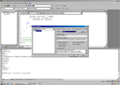

Reply 19 of 21, by Jo22
Update. Here are the files of the MZ700Win emulator, since the original website nolonger exists.
I've also attached the Win32s compatible binary. If Windows 3.1x ever gets DirectDraw, it may work.
Edit: Provided, that the "RtlFreeHeap" problem is solved, also.
Sharp's monitor is not included. It's not needed for testing, also: There's a substitute, "NewMon", created by fans.
The emulator also has an internal monitor, which is sufficient for testing and automatically activated if a monitor file is missing.
    33.22 KiB
    270 views
    Visual C++ 5.0 on Japanese Windows 98SE
    mz7_052s.zip
    114.76 KiB
    5 downloads
    mz700win source (original, unaltered)
    mz7_052.zip
    144.3 KiB
    4 downloads
    mz700win program (original, unaltered)
    mz700win_with_reloc.zip
    169.87 KiB
    6 downloads
    My binaries of mz700win (MSVCRT, CRTDLL) w/ .reloc section
    font.zip
    1.74 KiB
    5 downloads
    Font file
