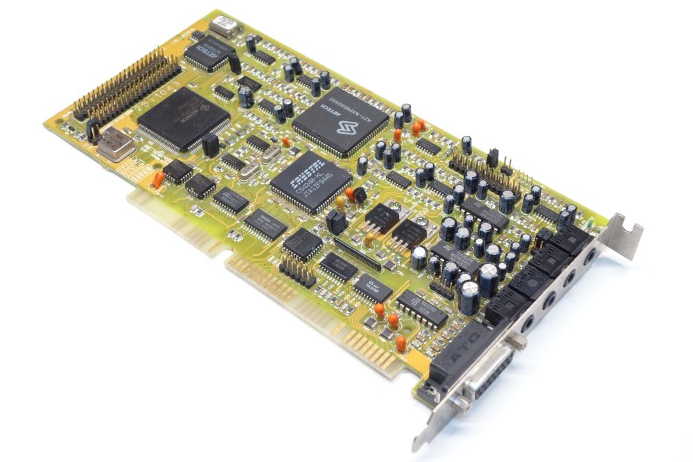

Reply 7 of 44, by appiah4
That card looks like MMSN842/855 Multimedia Audio Telephony 3200/3260 with the modem part missing so try the audio drivers for that IMO.
Drivers for those cards can be found attached to this post on VOGONS.
MMSN824 will not work that card has a Crystal Codec.
Reply 8 of 44, by DerBaum
good call...
appiah4 wrote on 2023-09-07, 09:35:

Reply 10 of 44, by Paradoxpm
FYI Windows 95 recognized it as a Washington 16. It loads the drivers automatically but no sound.
Reply 11 of 44, by DerBaum
Paradoxpm wrote on 2023-09-07, 11:45:
If i remember correctly the washington has a crystal codec...
This MMSN850 should be the Washington: (Also called Sound Galaxy Nova 16 Extra II)

Reply 12 of 44, by appiah4
The AZT chip is common with a Washington and apprently the device ids are the same as well but the Codecs are definitely different and those drivers won't get any sound from this card. Please try the drivers I linked above.

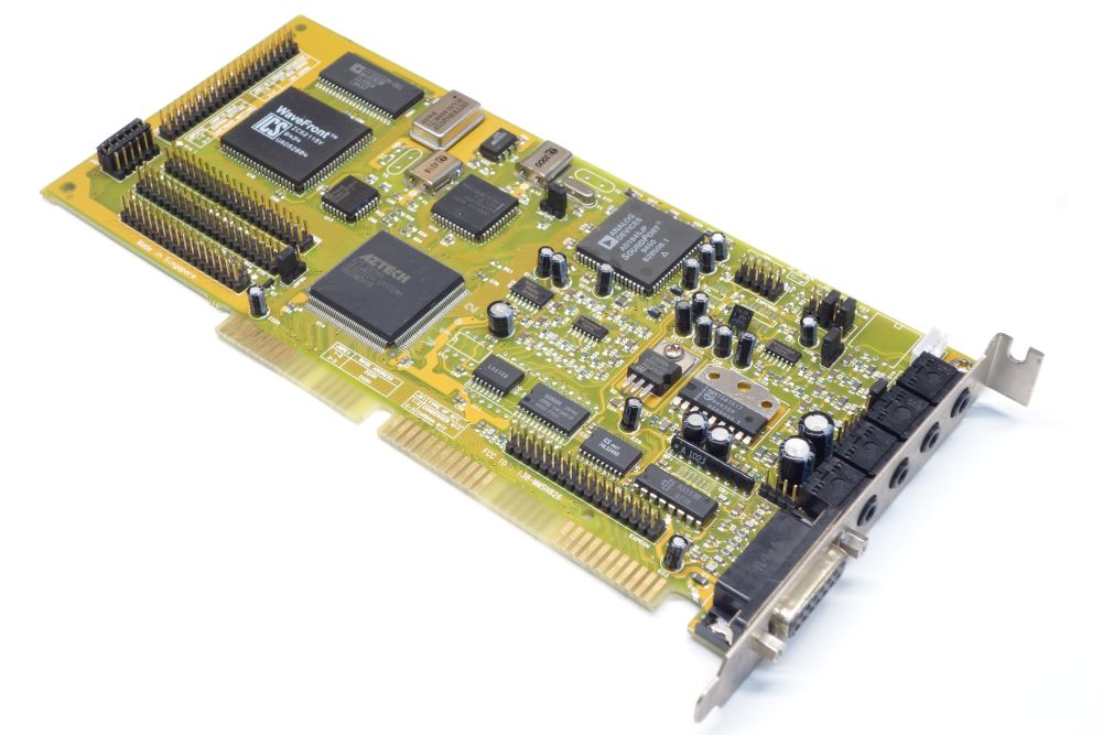

Reply 14 of 44, by dionb
DerBaum wrote on 2023-09-07, 14:56:
The codecs were interchangable and Aztech could & did release cards of the same type with either Crystal or AD codec, just like they mixed & matched real OPL3 & YAC512 and their clones.

Reply 16 of 44, by dionb
DerBaum wrote on 2023-09-07, 18:01:
[...] Can you provide an example? I would like to take some notes for my list. Until now all cards i have always have the same c […]
Until now all cards i have always have the same codec for the same fcc id.
I am working on a sspreadsheet to identify the all aztech soundcards properly based on the used chips.
Couple of examples...
MMSN822 AD:
MMSN822 Crystal:
MMSN824 AD:
MMSN824 Crystal:
MMSN826 AD:
MMSN826 Crystal:
61488800457c87bd8c8905cf9912
And my personal favorite Aztech card, the MMSN810 - AD:
MMSN810 Crystal:
