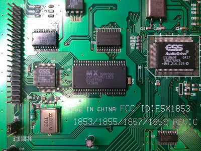

ESS sound card with 2MB wavetable chip - DONE

My dispute on Ali was successfull and I got full refund. So I ordered another pair of chips. They arrived today. Both are working but was filled with some unknown firmwares (I was not able to identify some readable strings to point out), so they was obviously recycled. Never mind, I erased them and programmed the ESS image, verify OK. So I'm satisfied for that cheap prize 😀

I replaced the FlashROM on the soundcard. I then also added a wire from pins 1 and 44 (WE#, WP#) connected to 5V to prevent them floating (not on the photo). It plays well. Thank you.

I have this ESS soundcard with populated all chips, Wavetable stuff for General MIDI included, if you need to check something, measure something how it is connected or something, you can ask me. I also found a way how to disable internal midi and switch it to external wavetable connector, all you need to do is just to disconnect krystal and wavetable connector will start working and vice versa, you connect it back and internal midi is playing. I added jumper to switch between these positions. Unfortunatelly my krystal has already damaged inscription, all I see is 33 something, but it didn't work at all when I tried different one or when I tried just a little bit different, Doom sounded like Mozart instead of metal. 😁
I have one problem with this card, when internal midi is playing, there is a lot of background noise, do you know if it's possible to fix it? I tried a lot of things with no result.

I made this modification to my ESS Audiodrive card with an ES689F chip, and it worked without any problems. Be careful because the memory chips I bought from Aliexpress were used. I tested two, and one was throwing errors (it's worth buying a few). My XGecu T48 programmer requires a special adapter marked "ADP_S44_EX-1.", the universal adapter pictured earlier won't work with this programmer. I recorded the melody from the Happyland Adventures game on 1MB and 2MB memory. The difference is easy to notice. I think some instruments might sound nicer, but we have what we have 😉

BTW what's that small daughter-PCB on the right upper corner of your card?

Good question. I have three cards of this model, each slightly different. The small board is marked "3-D SOUND." The card I modified is the version with the button. When it's not pressed, the sound is much louder and identical in both speakers. When it's pressed, surround sound is activated.
The second card has the same board but without the button. The card itself is also missing a small memory chip for the PNP function.
The third card is the poorest, no 3D sound board, no wavetable, no PNP chip.
It's easy to see that these 3-D boards might have soldered potentiometers, probably for adjusting the volume of the right and left channels. It would be nice to install them, but I don't know what resistance they should have or whether this requires modifying the SMD components on the other side of the board.

Aha, I never seen this before on ESS cards. Mine has already 3D chip on the main board...
Potentiometers - if they are placed before power amp or at line out you can use some 1k-10k, not much critical value. But surely some jumpers/resistors that bypass the pots would need to be removed.
Mine ESS on that I modded ROM has not lineout only speaker out so I plan to add one lineout jack and tap the signal before pwramp that is a bit noisy (I use external HiFi PA).
