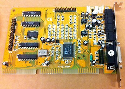

I just installed this Diamond Audio ISA Sound card in my Gateway 2000 486dx-33
It is SB-16 compatible. I used this card because this is all I had on hand with a CDROM controller.
Works great and easy to setup.
Works okay, Audio is okay, A little heavy on base and no way to adjust tones.
These where selling for cheap back in 1995/96 about $10 each. at electronics stores.

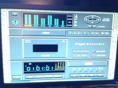

Comes with a music program that looks like a home stereo.
Buttons function the same as a home stereo.

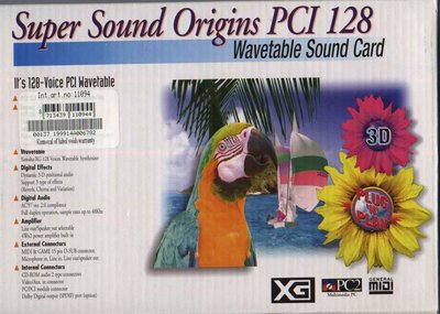

They later came out with Sound Origins 128-bit card.
with Yamaha XG 128-bit chip.

Looks like you have an ALS007 or ALS100 based card, same as the one discussed on page 5/6 of this thread. These cards are probably some of the best dos sound cards out there in terms of compatibility - just add a wavetable card or external synth

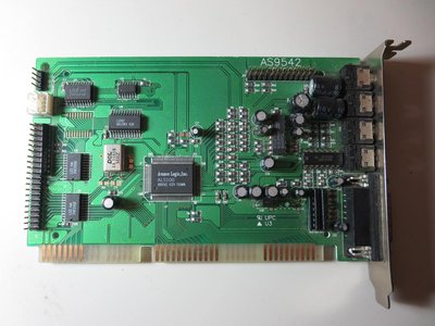

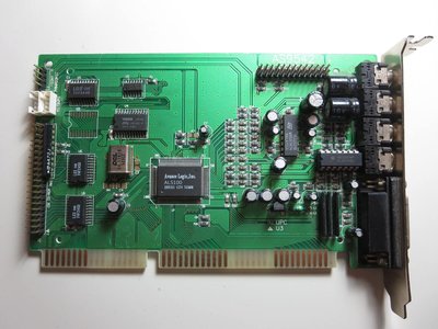

This is the card i'm using. I know that the LS262 is supposed to be genuine OPL3 but I have several less useful cards with a genuine YMF262 so i thought i would transplant it across anyway. I also upgraded the opamp as the LM324 isn't really good enough for audio
256.49 KiB
4588 views
ALS100 stock
258.99 KiB
4588 views
ALS100 with genuine opl3 and upgraded opamp

The illegal clones of the YMF262 are usually 99-100% accurate, but I'm curious if the ALS100 has the companion DAC built in or if that's also a clone chip (maybe the 74F244)?
Reply 195 of 414, by oohms
It seems that the digital output of the YMF262 is directly fed into the ALS100
