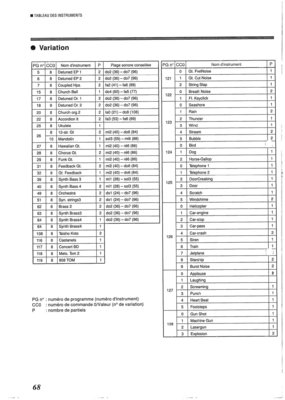

Does anybody have 4 pictures from 1st and 4th messages of this topic? They are not available.
Else another info about french SC-55 GS STANDART and 81, 122 tone.
