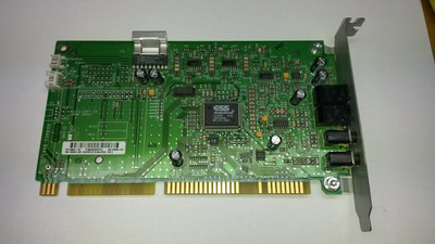

Reply 170 of 314, by varrol
I've got a question regarding the card I have (picture attached) - it looks different than the ones I saw - branded by Compaq. I have it for like 15 years.
Is it any good? Does anyone know this specific model? This is ES1869 not 68 - not sure how different they are.

Reply 172 of 314, by appiah4
ES1869 is basically ES1868 with an integrated 3D Spatializer. It requires different drivers but it is virtually the same chip otherwise. Your card lacks a joystick port, wavetable header and an IDE connector but for basic SB Pro compatibility, decent PCM audio and ESFM music it is a decent card.
Reply 173 of 314, by gdjacobs
My 1869 works with 1868 drivers. I don't care about 3d enhancement, so I don't care if the drivers can't toggle that feature. The older drivers allow manual resource assignment, so they have the added benefit of not needing a PnP manager.

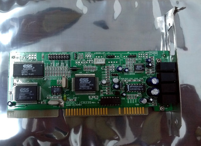

Reply 174 of 314, by brownk
664.07 KiB
1942 views
Bought an interesting noname card. It has four ESS products; ES1868F (PNP), ES981P ROM, ES689F Synthesizer & ES938J 3D Effector. With appropriate buzzwords, it could have been something to boast. The card needs some maintenance but somewhat miraculously all chips are in good shape.
Here's a recording of ES981P + ES689F.
http://tenorman.info/pc/es1869f%2Bes869f
