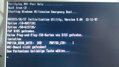

Hi,
i'm running a Tualatin System with a ISA Slot,
i can't get the TT1816 with ADI1816 Driver for DOS Detectet.
The Driver tells me the BIOS has'nt detectet the PnP Card 🙁
It works fine under Windows ME.
Anyone knows a Solution for this Problem ?
The Driver seems to have no switches for Forcing initialisation..
Seems like the FR33E has no ISA PNP Part in BIOS.
Thanks
Matthias

Reply 5 of 9, by matze79
The attachment photo_2017-07-14_15-29-13.jpg is no longer available
PnP BIOS found.
No Plug and Play ISA Cards found by BIOS.
ADI-Board not detected.
EDIT: Plug & Play OS is disabled in BIOS.
Card works fine under Windows and Linux.. but MS-Dos.../9x DOS Mode..

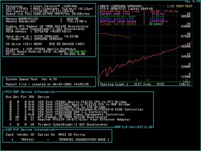

Reply 7 of 9, by zyga64
matze79 wrote:
Does not work with Intel ICU.
Did you tried Speedsys (ie. from Phil's DOS benchmark pack) ? Just run it in plain DOS, cancel tests and press I, to see PCI/ISA informations.
My looks like this
Maybe your DOS 8.0 from Windows Me is so different...

Reply 8 of 9, by matze79
No, its just DOS 7 with HIMEM integrated to IO.SYS. 😀
It works now..
i had to get a different AD1815_6.SYS..
i was supplied with wrong Driver Disc..
The Card is a TerraTec Soundsystem Base 1. Not TT1816.
Now everything is fine 😀
Thanks for pointing to the right Direction.
The attachment TUALATIN.jpg is no longer available
Reply 9 of 9, by zyga64
Probably drivers from TT1816 disk should also work, if you changed Vendor string in config.sys to TER1411.
