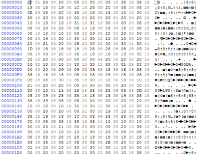

Have to bump a thread since recently I did some research around Creative CQM chips, and seems I found the (fully) software way to detect if a CQM chip is used instead of OPL3.
As I found out, setting bit 0 of LSI Test register (bank 0 index 1) on CQM chips makes bits 0-6 of status register return some sort of unknown counter value:
36.48 KiB
164 views
CQM (CT3600) Status register REP INSB dump after LSI Test set
If OPL timers/IRQ were used, their status bits seem to be XORed with "counter" values. Setting bit 0 of LSI Test register back to 0 clears bits 0-5 of status register to 0 and brings the chip back to normal operation. Overall, this type of detection seems to not have any side-effects on OPL operation (at least I didn't had any troubles with other games/apps after running those tests)
Setting bits 1 or 2 of LSI Test register causes brief click in audio output, or ,rarely, hanging notes; bit 0 flipping seems to be silent. Other bits appear to have no effects observed.
I did a bit more tests with my pile of OPL3-capable soundcards, and it seems, apart of CQM, none of them have such effect while fiddling with LSI Test registers, thus, this quirk could be used to distinguish CQM from other OPL3-like chips.
For now, I have been able to reproduce this behavior on CT3600 CQM, CT4520 and ViBRA16C cards, so I think other CQM-equipped cards do the same :)
I've also attached an archive with all the tools made and used:
- OPL_ID detects an OPL chip and displays its type (OPL2 single/dual, OPL3/OPL3-L, ESFM or CQM)
- LSITEST flips each bit of LSI Test register of both OPL3 banks, additionally checking index 0, and displays Status register value in form of
Test Bank0 REG00 = 01: 00 08 20 00 C0 C0 E8 C0 A0 A4 80 A0
where the results are split into groups of 4 values (before LSI Test set, immediately after, with 1024 reads delay and finally after LSI Test clear); the groups are "timers not used; Timer 1; and Timer 2" respectively.
- OPLDUMP flips bit 0 if LSI Test Registers and dumps Status register content via REP INSB for further examination (TEST_NOT.BIN - timers not used, TEST_T1.BIN - Timer 1 triggered)
All applications test port 0x388 by default, but this can be overrided by command line, e.g. OPL_ID.EXE 220
please check these on other sound cards and OPL chips (I'm particulary interested in genunie YMF262/YMF289 tests, as closest I had was "LS245" clone on ALS100+ card and YMF71x/724, but other cards are always welcome), and have fun :)
    OPL_ID.ZIP
    267.56 KiB
    12 downloads
    OPL2/3 Detection/LSI test stuff and results
--wbcbz7

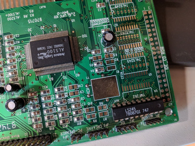

Reply 38 of 41, by georgel
wbc wrote on 2023-09-22, 19:33:
... was "LS245" clone on ALS100+ card and YMF71x/724, but other cards are always welcome), and have fun 😀
You probably meant LS262, because LS245 is a mere TTL buffer which is also present on your sound card and externally looks similar.
Reply 39 of 41, by wbc
georgel wrote on 2023-09-23, 09:44:
nope, there are no LS245 buffers soldered on my card (although there are footprints to support IDE interface), and that "LS245" chip is sharing traces with YMF262 footprint on my card:
274.26 KiB
97 views
which is consistent with findings from this thread: All the truth about FM in ALS100 Plus+ cards (includes facts, tech info and tests)
--wbcbz7
