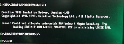

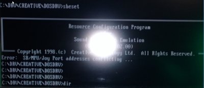

So i installed those dos drivers you posted earlier and was greeted with all these errors. Much help appreciated

Reply 6 of 16, by JaKSLaP
skitters wrote:
What do the contents of your autoexec.bat and config.sys files look like?
Autoexec
SET MIDI=SYNTH:1 MAP:E MODE:0
SET BLASTER=A220 I5 D1 H5 P330 T6
SET CTSYN=C:\drv\creative\dosdrv
C:\DRV\CREATIVE\DOSDRV\SBEINIT.COM
C:\DOS\SMARTDRV.EXE /L /X
PATH C:\DOS
lh c:\drv\mouse\mouse.com
Config.sys
BUFFERS=10,0
SHELL=C:\DOS\COMMAND.COM C:\DOS\ /p
DOS=HIGH,umb
DEVICE=C:\DOS\HIMEM.SYS /testmem:off /Q
DEVICE=C:\DOS\emm386.exe I=B000-B7FF RAM D=256 AUTO
Reply 7 of 16, by skitters
I don't see any problems there.
Did you do any other editing?
The readme says...
The sample bootfiles use the drive and directory structure given in a. one step above. You need to modify them if you have […]
You need to modify them if you have unpacked to a different
location.
You also need to modify the path of the entry "waveset"
in the file CTSYN.INI accordingly.
so make sure those paths are correct.
The Readme also says
If you experience any problems such as no sound, interrupt conflicts or else, try to modify the settings for your driver using
SBESET.EXE, or modify your BIOS settings following the instructions
given in the HTML file.
and toward the end of the "sblive in dos" file in the "howto" folder there is "An alternative scenario was worked out by Shifty for those who are still having difficulties" with a suggestion for sbeset.
An alternative scenario was worked out by Shifty for those who are still having difficulties even with the previous procedure: […]
You'll need the sbeset command that should come with the dos drivers, I'm assuming it's in your c:\sblive\dosdrv directory. At the command line, type:
c:\sblive\dosdrv\sbeset -I10 -w0
That's an *upper case* letter "I" followed by a one and zero to set the IRQ to ten, then a lower case "w" followed by a zero to tell it to ignore your Windows configuration. Sbeset should also automatically set your blaster environment variable. Now all you need to do is make sure you have the line
c:\sblive\dosdrv\sbeinit
in your autoexec.bat, reboot into "pure" DOS and give it a go. Changing the IRQ to 10 did wonders for me, I have no idea why because there's nothing on the default of 5 that should be conflicting with it. Don't be scared of experimenting with different values under DOS, you're unlikely to be using other devices that would normal conflict under Windows.
One limitation other than the settings can also be your motherboard
configuration and compatibility. You will need to check with the motherboard manufacturer and ask them does their motherboard fully support NMI (Non Maskable Interrupts) and if it does how to enable them. Some manufacturers of motherboards state that they do support NMI but when tested and used (like with the SB128/Live) they don't work. If you have a ALI/ASUS chipset/motherboard an updated BIOS is now available which supports NMI, check out http://www.asus.com.tw for this patch. Until the motherboard fully supports NMI then the software emulation simply cannot operate. Check with the respective motherboard supplier for NMI compatibility. (Tip from FRK)
I'm afraid I don't have any first hand experience using SBLive DOS drivers under DOS 6.22.
I've only used the DOS emulation on a computer with Windows 98, which is a LOT easier to configure.

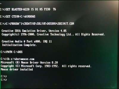

I finally got it to work by downloading dos drivers that have a setup from MSFN.COM, just when i was about to give up.
http://www.mdgx.com/sbdrv/sbldos2.zip
http://www.msfn.org/board/topic/115903-compil … for-windows-9x/
i deleted everything from config.sys and autoexec i ran the installation and it configured everything automatically.
I still got the "EMM386 not installed" error but i still worked, then then added in "noems" after device=c:\windows\emm386.exe and the error went away.
Then added mouse driver and now have street rod 2 working in perfect full screen, with sound and mouse support. I tried to smartdrive and got all these errors so i just removed it.
Thank you so much for all your help. Epic Pinball is running perfectly now it full sound blaster support. Now i just gotta figure out why OMF runs so fast 🤣.
