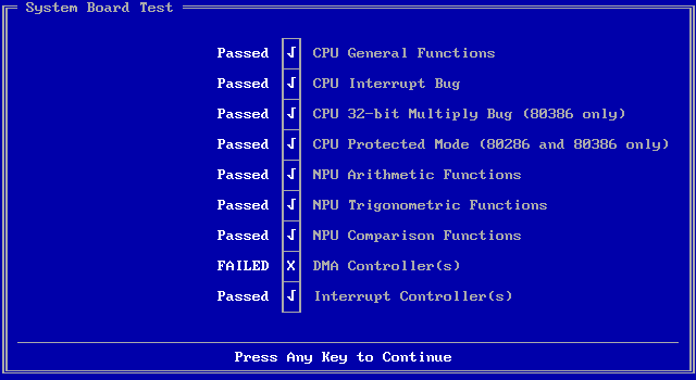

Maybe it is somehow related to ISA DMA ? Maybe the DMA controller is buggy or there's a conflict with DMA1 and DMA5 (SB16 high DMA).
In that case, run a diagnostic program like CheckIt (system board test) or the DMACHK utility of UMBPCI. Maybe it helps.
The latter is only intended to check ISA DMA regions, not the actual controller itself.
Sorry, just guessing. Maybe disabling the COM ports could also help (since your board has two of them) ?

I have tried what you have suggested and It comes up with zero conflict. Although, the version of Checkit that i found looks different than the one you have an image of.
