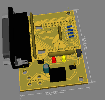

Hi,

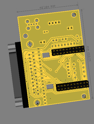

another project in progress :
USBLPT : an usb parallel port that behaves like a real parallel port
The attachment usblpt1.png is no longer available
The attachment usblpt2.png is no longer available
The board plugs on a dev kit.
This is based on USB2LPT project, high speed version 1.7, based on the Cypress CY7C68013A : https://www-user.tu-chemnitz.de/~heha/basteln … PT/index.en.htm
(it is not the atmega project(low speed version) but the cypress high speed version).
This project has a nice software driver that can emulate a legacy USB port, including input and output instructions.

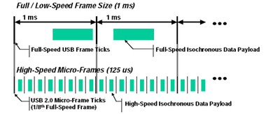

It will not be a perfect solution, as it is still limited by the USB frame timing, for high speed that is 125us
The attachment usbpacket.png is no longer available
But I hope we can get quite far with this (for example connected to dosbox and have real opl2 music on a modern laptop over USB)

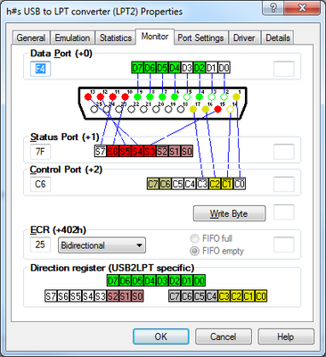

Reply 1 of 15, by dreamblaster

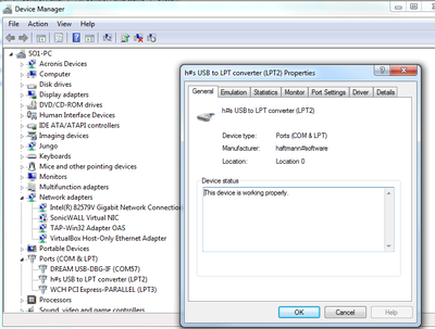

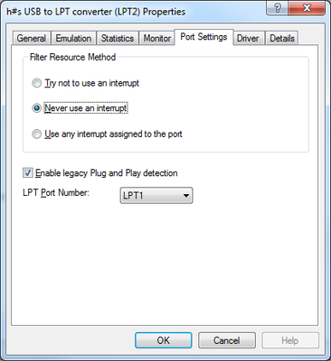

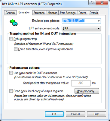

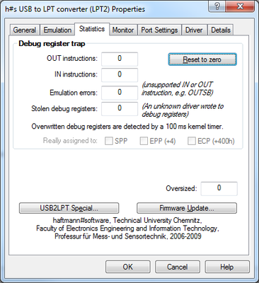

I already tested driver + the cypress dev board, flashed with the right firmware,
and the printer port driver options looks good :
The attachment usblptdrv01.png is no longer available
The attachment usblptdrv02.png is no longer available
The attachment usblptdrv03.png is no longer available
The attachment usblptdrv04.png is no longer available
The attachment usblptdrv05.png is no longer available
This is on windows 7 64 bit.
Once my board prototype is ready (in a few days, waiting for components but I have the pcb's),
I will be able to test if it works for our purpose.
Thanks for your support !

Sounds like a very interesting concept, and the driver looks quite good. The speed of the USB does seem like it might be a concern, though mostly for the games that do sampled sound using the Adlib or such. I think there was a post on the OPL2LPT thread with someone benchmarking their parallel port in the order of 2us, and the Adlib needing ~3us + ~23us delay between writes. Perhaps a solution would be to pack multiple bytes into each micro-frame, each a division of the micro-frame timing?
Reply 4 of 15, by dreamblaster
I assembled the first prototype, see photo :
The attachment USBLPT01.jpg is no longer available
It seems to work, basically, the printer port is detected, driver installed,
and I when I set one of the data lines high, it effectively goes high.
A quick test with adlipt driver in virtualbox did not work,
this needs more investigation.
