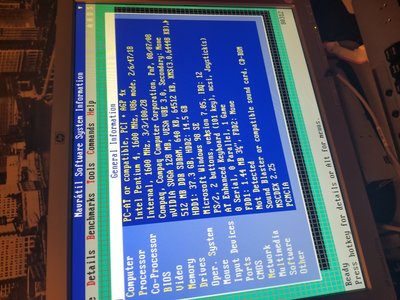

i have a C-Media CMI8738 pci card and im trying to get it to run on a hp d530 computer and i am having problems getitng sound to work i have tryed two games duke nukem 3d and the secret of monkey island both give no sound at all i have used the drivers from here https://www.philscomputerlab.com/c-media-cmi8738.html when i configured the sound card in duke nukem 3d the fx rest will not play at all it just gives me an error and it trys to plays the musdic test but i here no sound if anyone has got this card to work in dos please let me know how you did it 🤣

Reply 5 of 13, by Jo22
Did you try NSSI and if so what does it say ?

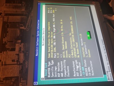

Reply 7 of 13, by Demonslayer2103
Ok never mind I figured it out here is what I got

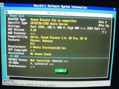

Reply 8 of 13, by Jo22
Hm. It finds Sound Blaster, good. What happens if you press "l" (Multimedia) ?
When I tried ~8 years ago, the working card looked like this..
114.91 KiB
1358 views
Reply 10 of 13, by Jo22
Interesting. Your card reports a newer DSP than mine did way back in the early 2010s (4.12 vs 3.02).
Not sure if that revision is real or just an illusion. (To mimic a specific Sound Blaster DSP.).
I'd try different drivers now. Starting with CMI8X38D.zip w/ setaudio.com v1.98,
then 38dosv2.zip w/ setaudio.com v1.3 and so on.
