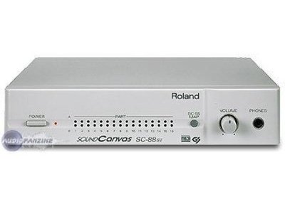

I remember comparing a Roland SC-88ST with the SC-55 map, and a CM-300 (home version of SC-55), and the main difference I could hear was better clarity from the SC-88ST. Tried various games and just ended up using the SC-88ST instead.
