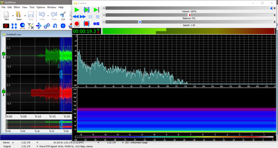

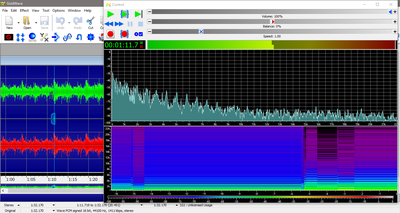

The thing about Cloudschatze's table is it represents the possible output from the soundcard compatibility list (of each game) not the actual game samples' quality.
For example Duke3D is 11khz 8bit mono. I checked. The early Westwood games (C&C, Red Alert..) are 22khz ADPCM which is basically 12bit-ish quality-wise. Quake is 11khz, not sure about the bit depth.
What makes these games sometimes sound better with higher sampling rates is just that there is less filtering and added aliasing, giving you the illusion of extra frequency information that was never really there.
I really can't think of any game that uses high quality samples that merit the use of a 16bit 44kHz capable sound card that can't also benefit from being run on a Pentium or greater architecture. At which point, Windows 9x with a PCI sound card makes more sense than any ISA card.

Just made some audio captures of the line-out from the card.
Seems the card outputs up to 11kHz (with a 22kHz sample sourcefile) and then, like on the SB16 cards there is a brickwall/lowpass filter kicking in.
On the FM output, there is NO filter and the output is steady up to 22kHz with no dropoff.
I'm liking this card more and more with the exception of the DOS drivers which suck ballz. 😀

Digital Audio @ 22kHz Stereo 8bit

Adlib FM synth
