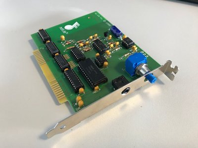

I built the AdLib reproduction card
First post, by root42
And I have to say it was extremely fun! The project is very straightforward. Boards were manufactured by aisler, parts ordered at Mouser and the Yamaha chips off of eBay. Soldering took all in all maybe 1.5 hours. Plus I had to assemble a barebones 286 from old parts off of eBay. The card worked on first try! I still have to drill holes in the bracket and have to get a case for the 286.
Two problems I noticed: the card is quite noisy. This isn't particularly notable when music is playing, but maybe it's the way those old cards were.
Second, the potentiometer I used seems pretty direct. Maybe it's a linear one? It certainly doesn't feel logarithmic. I used the parts described in the project (https://github.com/schlae/adlib).
The final product:

Reply 6 of 22, by matze79
You can solder a 1/10 Value Resistor parallel to potentiometer output and ground to make it more logarytmic.
A 7805 regulator with proper filtering on the card feeding the ic's and powered from 12V line reduces the noise.
Many Soundcards did it this way.
Reply 7 of 22, by root42
The idea with the regulator sounds interesting. But I think I don't want to shoehorn it on my existing board. Would be nice to augment the PCB design, though.

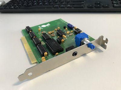

Reply 10 of 22, by root42
I also have the first bracket now done. I use the Keystone brackets that are available at several vendors. A colleague and friend of mine has a good stationary drill which we used to drill the two holes and used a countersink to make it nicer. It's a bit of work, but fits really well and looks good.

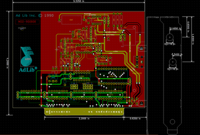

Reply 13 of 22, by keropi
root42 do you have any measurements on where to drill the holes?
I build some cards for a friend and it would make life easier to know where to drill exactly 😀
Reply 14 of 22, by root42
Sure, screenshot of KiCad attached. There you see the dimensions of the holes.

Reply 16 of 22, by root42
keropi wrote:
^ great thanks!!!

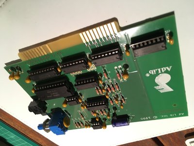

No problem. Make sure to mark the holes first and hold it against your card. My experience is that it's a bit tricky to get it right. Also be careful of the metal deforming or shredding while drilling...
My last card worked out relatively fine and looks like this (countersink is a bit too large for the potentiometer and headphone jack):
