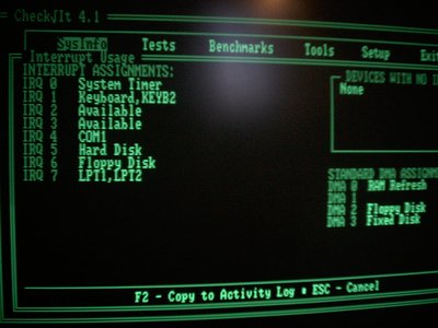

Reply 3 of 23, by Jo22
digger wrote:
By the way, I never understood why Creative didn't standardize on IRQ 5 in the first place, since IRQ 7 was already in use by
the LPT1 printer port on most DOS PCs, but IRQ 5 was usually free. 😒 .
IRQ5 was not free on the PC/XT platform. It was used by MFM/RLL hard disk controllers there. 🙁
IRQ7, on the other hand, was more or less free. It rarely happened that a line printer was in use while a game was running.

Reply 15 of 23, by Jo22
David_OSU wrote:
On my old DOS machines, I set the soundcards to use IRQ5 because IRQ7 was already used for the parallel port.
Hi, digger explained it very well I think. 😀
I got my information from the web, as well as from my own PC/XT clone, a Nixdorf 8810 M85 (specs of another user's page).
Source: http://philipstorr.id.au/pcbook/book2/irq.htm
I've added a screen shot below. I didn't change any of the IRQs when I got it. The machine was first built in ~85.
The MFM/RLL drive is an ancient 5,25" model with 20MB, along with an equally old controller card.
So unless the owner had made some changes, it had always been configured for IRQ5.
David_OSU wrote:
I had always thought that the first parallel port (LPT1) should be on IRQ7, and a second port (LPT2) on IRQ5, if you had two printers.
So normally, IRQ5 was free.
Well, yes and no. While, the IRQ for LPT1 indeed often was IRQ7, LPT2 wasn't always on IRQ5.
In my PC clone, both are on IRQ7. That's because both the on-board LPT as well as the LPT on my Hercules clone are hard-wired.
That's why I'm afraid that in the 1980s, not all expansion cards containing an LPT port were configureable in this respect.
Amyway, as digger pointed out, IRQ sharing at least was no issue in DOS. DOS didn't do port probing as Win9x did.
So I believe that -unless you had something like DESQView with a printer spooling running-, having both SB and LPT on IRQ7
caused no real harm. When PC/AT machines became ubiquitous, Creative switched to IRQ5. Simply because it was safely free now.
I believe the change happened with the SB Pro 2, but I'm not 100% certain. It was roughly after the SB 2.x and before SB16, though.
Edit: Quote and link added.
    240.72 KiB
    2524 views
